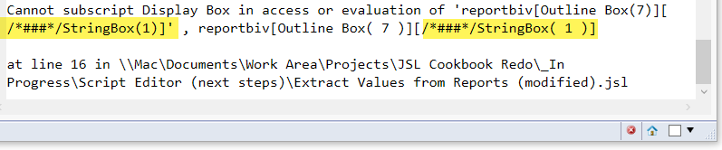

      3. Run the script. You’ll get an error message saying that a display box can't be subscripted.DonMcCormack_0-1648828080059.png
        The same details are written at the bottom of the log.
        The mark /*###*/ is used to show where the error occurs. In most cases, a line number is also given.
      4. On line 18, StringBox is not colored blue because it isn’t recognized by JSL as a function or object. Position the cursor between String and Box and simultaneously press the CTRL and Space keys (Option+Esc on the Mac). This displays the Autocomplete window using the string to the left of the cursor. Select String Col Box and delete the second Box.

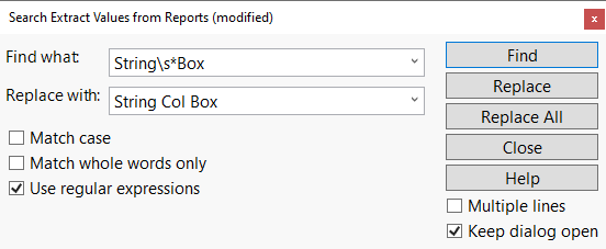

      5. If we try running the script again, we will get the same error on line 18. Select the word StringBox and press CTRL-F (Command-F on the Mac) or select Edit > Search > Find. Find and Replace will let us do a global replace of this phrase with the correct one. One of the more powerful features of Find and Replace is the ability to use regular expressions. For example, the expression below would replace any occurrence of the consecutive words String and Box regardless of the amount of white between them. This is helpful if both StringBox and String Box appear in the script.DonMcCormack_2-1648828080062.png

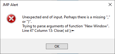

        1. Delete the close parenthesis on line 45 and run the script. The error message identifies the missing fence as the problem but indicates the last line of the script as its location. DonMcCormack_3-1648828080063.png

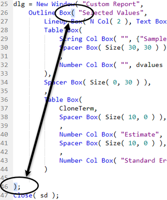

        2. Position the cursor between the close parenthesis and semicolon on line 46.  The open parenthesis on line 26 is identified as its match. DonMcCormack_5-1648828080067.png
        3. On line 25 position the cursor between the final “w” in Window and the open parenthesis. It is highlighted pink because there is no matching close parenthesis. DonMcCormack_6-1648828080068.png
        4. Double click the open parenthesis on line 26. Everything between it and its closing match is highlighted
        5. Move the cursor to the end of line 28 and press CTRL and the right square bracket at the same time. Use Command and B on the Mac. Everything between the first opening parenthesis to the left of the cursor and its closing fence is highlighted.

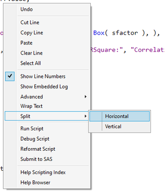

      7. Finally, its sometimes handy to split the script window so code in different parts of the script can be compared. To do this, right click and select Split > Horizontal or Split > Vertical.
