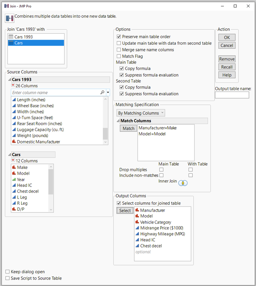

  3. Join the two tables as shown in the dialog below. We will only need a subset of the columns. DonMcCormack_0-1645819064904.png
