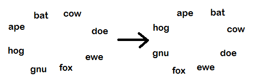

Problem
You have a list of items that you want to rotate, moving items from the beginning of the list to the end or the end to the beginning. You might think of the list as circular.
Rotate a circular listRotate a circular list
Solution
Use the Shift Into function, which does exactly that.
list = {"ape", "bat", "cow", "doe", "ewe", "fox", "gnu", "hog"};
Shift Into( list, 1 ); // move one from the front to the end
Show( list ); // {"bat", "cow", "doe", "ewe", "fox", "gnu", "hog", "ape"};
Shift Into( list, -2 ); // move two from the end to the front
Show( list ); // {"hog", "ape", "bat", "cow", "doe", "ewe", "fox", "gnu"};
