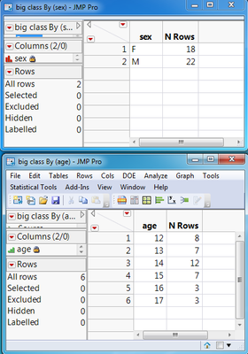

Solution 1:  Use summary tables.  The JSL below shows how to use Summary() to get a table that will have a row with each unique value in a single column.   You can then do further JSL table commands to get those values from the summary table.
_dt = Open( "$sample_data/big class.jmp" );
//create a summary table of the :sex column
_dt1 = _dt << Summary(
	Group( :sex ),
	Freq( "None" ),
	Weight( "None" )
//create a summary table of the :age column
_dt2 = _dt << Summary(
	Group( :age ),
	Freq( "None" ),
	Weight( "None" )
