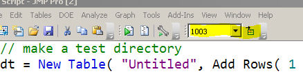

The first part of this example uses DeleteDirectory and CreateDirectory to make a clean set of sample files for testing. You might discover DeleteDirectory fails if any of the JMP tables are still open from a previous attempt; you can close the tables manually, even if they are hidden, using the table widget
Click the table icon beside the widget to open the hidden tableClick the table icon beside the widget to open the hidden table
