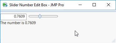

_nw = New Window( "Slider Number Edit Box",
	_vlb = V List Box(
		SliderNumberEditBox(
			"_neb1",
			Char( k ),
			"_sb1",
			"0",
			"2",
			"k",
_tb << delete;
_vlb << Append(
	_tb=Text Box(\!"The number is \!" || char(k))
_tb << delete;
_vlb << Append(
		_tb = Text Box( "The number is " || Char( k ) )
creates a window that looks like this (I changed the slider box to a different value)
