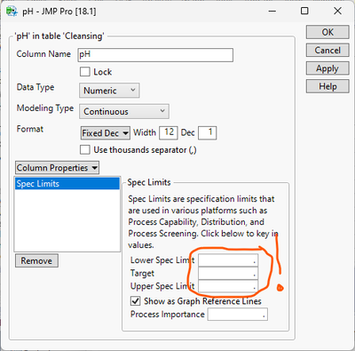

However, when you open the Column Info dialog window to see the values for the Spec Limits, they are missing!
What did JMP do? It seemed to work, but only partially! Why?!?

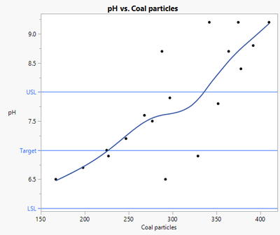

Finally, if I create a graph with the column, I see the Spec Limit reference lines in the expected locations.
