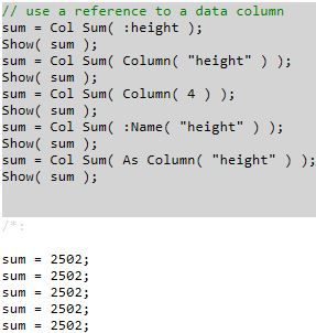

Our first test will use several different forms of a column reference for height.
// use a reference to a data column
sum = Col Sum( :height );
Show( sum );
sum = Col Sum( Column( "height" ) );
Show( sum );
sum = Col Sum( Column( 4 ) );
Show( sum );
sum = Col Sum( :Name( "height" ) );
Show( sum );
sum = Col Sum( As Column( "height" ) );
Show( sum );
OK, what did we get?
Same result every time. So my theory is that these five different references are equivalent. My first test confirms my theory. But it is only the first test. Let's devise another test. Let's first get the column reference, store it, then use the stored reference to compute the same statistic.

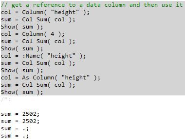

// get a reference to a data column and then use it
col = Column( "height" );
sum = Col Sum( col );
Show( sum );
col = Column( 4 );
Show( sum );
col = :Name( "height" );
Show( sum );
col = As Column( "height" );
Show( sum );
Note that I did not include the very first form of a reference, :height because the value returned and stored in the expression col = :height is missing (".")! That result is not helping my theory! What did we get with the rest of test?
Wait a minute! I didn't get a single error, but I didn't get the same result each time. The first two results are correct, but the last two are wrong. Let's perform one more test of my theory. Let's again obtain a column reference, store it, and then use it to send a message.

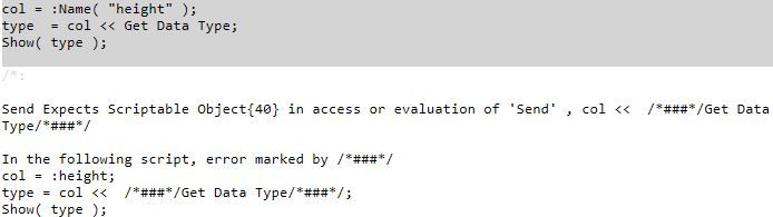

The first two ways seem to work as expected. Let's try the third way.
type  = col << Get Data Type;
Show( type );
This way didn't work.

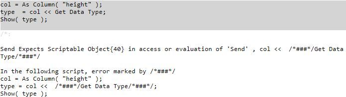

What about the last way?
Show( type );
I get the same error as the last time.
