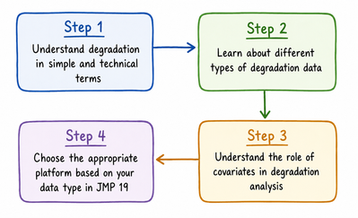

Figure 1. Overall flowchart for degradation analysis in JMP 19.
Alright, let’s begin our journey into degradation analysis.

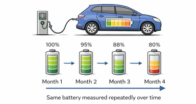

RMDT data occur when the same unit is measured repeatedly over time without being damaged. Because the measurement process is non-destructive, the unit remains functional and can be observed continuously.
For example, imagine monitoring the battery capacity of an electric vehicle. Each month, you record the remaining capacity of the same battery while it continues to operate normally. Since the battery is not destroyed during testing, you can track its gradual decline over time. This is a classic example of RMDT data.
Figure 2. Repeated measures degradation testing example.
Ask yourself: Does your data set contain multiple degradation measurements collected from the same unit over time? If the answer is yes, your data likely falls into the RMDT category. This type of data allows us to observe the degradation path of each unit in real time.

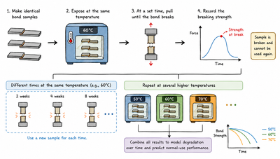

Now consider ADDT data. In this setting, the measurement process is destructive, meaning each unit can only be measured once. The test itself damages the unit, so it cannot be observed again. Instead of repeatedly measuring the same unit over time, degradation is assessed using measurements collected from different units at different time points.
RMDT is appropriate when the degradation characteristic can be measured repeatedly on the same unit without affecting its future performance. In contrast, ADDT is used when the evaluation permanently destroys the unit, making repeated measurements impossible. Since the degradation path cannot be observed directly for a single unit, it is reconstructed by combining measurements from multiple units.
For example, consider testing how the strength of an adhesive bond changes over time at higher temperatures. Several samples are exposed to the same temperature but for different lengths of time. After a specified exposure time, a sample is removed and pulled until the bond breaks. The force required to break the bond tells us how much strength it has retained. Because the bond must be broken to measure its strength, that sample cannot be tested again. A different sample is therefore needed for each exposure time. The same process can be repeated at several elevated temperatures to accelerate degradation. By combining measurements across different temperatures and exposure times, we can characterize how the bond degrades over time and predict its performance under normal-use conditions.
Figure 3. Accelerated destructive degradation testing example

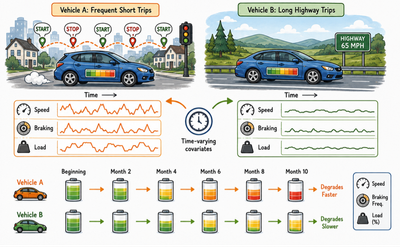

In degradation studies, degradation may depend not only on time but also on other factors that affect the overall degradation process. When these covariates change over time, they are referred to as dynamic covariates.
Unlike static covariates, dynamic covariates capture how a unit’s characteristics evolve throughout the observation period. Their histories provide an exposure profile that can help characterize the degradation experienced by each unit.
For example, consider two vehicles operating under similar environmental conditions. Their usage characteristics, such as speed, braking frequency, and driving load, may change from day to day. One vehicle may experience frequent short trips with repeated acceleration and braking during one period, followed by longer highway trips during another, while the second vehicle may have a different usage history. Although the vehicles operate under similar environmental conditions, these different exposure histories may lead to different degradation paths. This illustrates a key feature of dynamic covariates: degradation may depend on a unit’s exposure history, rather than on a single static measurement.
Figure 4. Degradation data with dynamic covaraites example

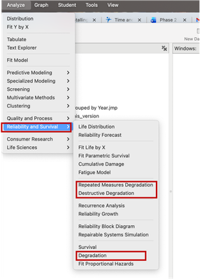

The degradation analysis tools currently available in JMP 19 can be found under the Analyze menu, within the Reliability and Survival section. There are three main platforms available for conducting degradation analysis:
  1. Repeated Measures Degradation: Used when the same unit is measured multiple times over time using a non-destructive process. It allows you to observe the full degradation path of each unit.
  2. Destructive Degradation: Designed for situations where the measurement process damages or destroys the unit, meaning each unit can only be measured once.
  3. Degradation: A more general platform that provides flexible modeling options for analyzing degradation data under different conditions.
The appropriate approach to degradation analysis depends primarily on how the degradation data are collected. Different data structures may be analyzed using different JMP platforms, with some overlap in functionality among the available platforms.
