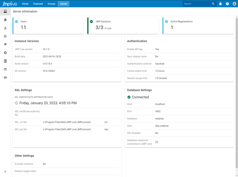

Server status page
The server information page is a new addition to JMP Live 16.1. We created this page to be the default landing area of the administration panel and to provide a new home for the configuration settings. Along the top of the page, we have highlighted the number of enabled users, a list of JMP Sessions currently in use across the pool and the number of reports in the regeneration queue. Other settings of note in the cards below are the SSL Certificate expiration date and the database connection status to help identify problems with the JMP Live instance.

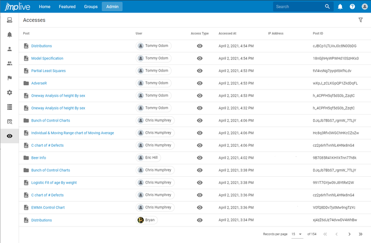

Post access table
The JMP Live admin panel also includes a new page that allows you to browse the view and download activity on every post in your JMP Live instance. Since this table is filterable, the admin can filter by users, access type, IP address and more, allowing an administrator to monitor more closely who is accessing resources on the JMP Live instance.
post_access.PNGWe also include a more limited version of the access table for individual posts in JMP Live, viewable by the post’s publisher. This table is found in the overflow menu of a post’s page.

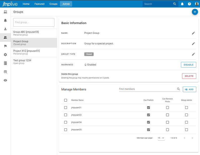

Group management
Similar in design to the user management page, group management allows an administrator to adjust the settings for each group on JMP Live. After selecting a group in the list, an admin may adjust the basic information about a group or even delete the group if it is no longer needed. The next section allows you to manage the members of the group. You may add new members, delete existing ones, or adjust the permissions for individual members.

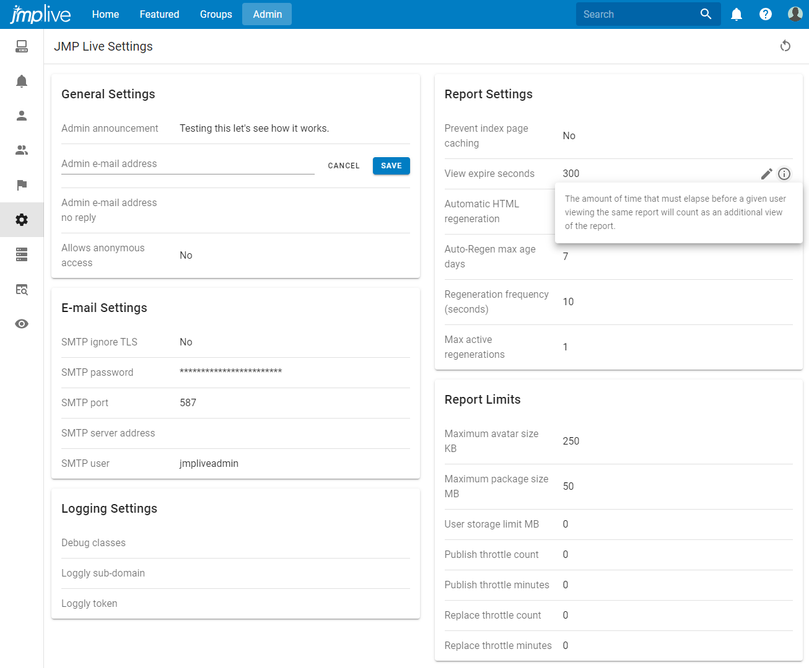

JMP Live settings
This page includes the runtime settings from the old admin settings page. The configuration settings are now surfaced on the new JMP Server Info page, which means that every setting listed on this page is editable while JMP Live is running. Each setting is individually editable and includes a pop-up description if necessary.

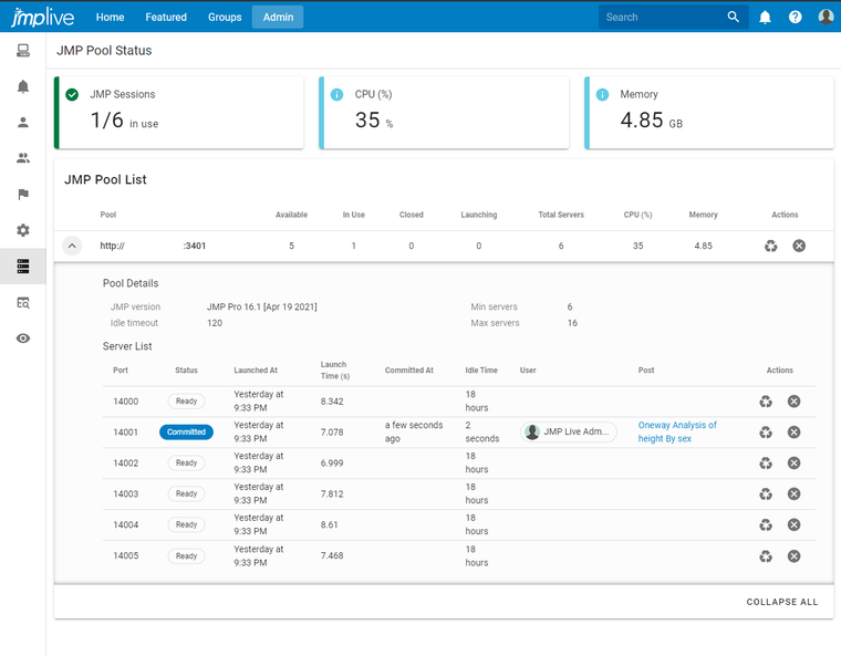

JMP Pool
The new JMP Pool panel highlights some performance metrics along the top of the page so an admin may quickly assess the state of the pool. Each pool machine is listed in the table with a summary of information about the servers within. However, if you need to manage an individual server, the list may be found in the pool’s details panel.

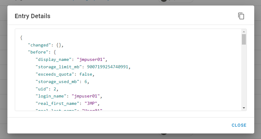

audit_log.PNGWe have also redesigned the details column to pop up a JSON viewer window so you can explore the full data associated with each entry.
