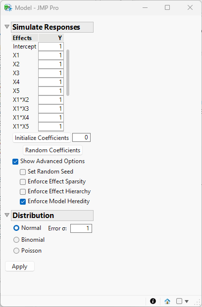

Smarter simulated responses
Simulating responses for a designed experiment is a great way to try out designs before collecting data. Thanks to some great teamwork from Mark Bailey, Joseph Morgan, and Jacob Rhyne, JMP 19 gives us a lot of flexibility for simulating responses. The new Enhanced Simulate Responses lets you simulate responses using random coefficients – a great way to simulate responses where you can investigate what happens to the responses (and modeling) when only a few of the coefficients are nonzero (and of different magnitudes). The random coefficients provide options to enforce effect sparsity, effect hierarchy, and model hereditythat underly our assumptions when designing experiments.
Previously, the Random Coefficients option in Simulate Responses was only available in Easy DOE and did not consider the structure of the model. Now, you can:
  • Control how many effects are active (sparsity).
  • Scale interactions and quadratics relative to main effects (hierarchy).
  • Ensure that if a second-order effect is active, its related main effects are too (heredity).
You can also reset the random seed for reproducibility, initialize coefficients to a constant, and adjust active proportions for each effect type. This update makes it easier to simulate realistic responses based on sound statistical principles, whether you're teaching, testing, or just exploring your design. Available in most of our DOE platforms, the new options will show up when you have Simulate Responses selected when creating your data table.

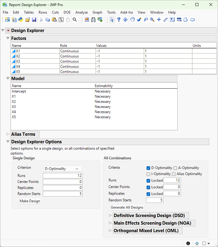

Modern screening designs now in Design Explorer
Design Explorer has been a favorite for quickly comparing custom designs, and in JMP 19, it’s gotten a major upgrade. You can now explore definitive screening designs (DSDs) and other modern screening options directly within Design Explorer – no need to build multiple tables or jump between platforms.
This update makes it easier to create and compare DSDs with different numbers of center points or extra runs and explore near-orthogonal arrays (NOA) and orthogonal mixed-level designs (OML) that were previously tucked away in Classical>Factor Screening>Screening Design.
Just launch Custom Design, and if you have a main effects model with continuous and two-level categorical factors that will accommodate these designs, Design Explorer will provide these additional options. Even if you haven’t used it before, check out Design Explorer as a great way to explore trade-offs and properties across multiple designs all in one place.
