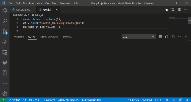

4.  Running JSL
You can press Shift+Enter to run your selected text, or the whole file if nothing is selected. Or you can press Alt+Enter to run just the single line you're on. We went with the VSCode standard for running instead of Ctrl+R because it felt like it flowed better with other extensions. Also Ctrl+R is already taken. But don't worry, VSCode lets you edit pretty much everything, so you can set anything to any keybinding you like. It will freeze up your current instance of JMP a little, but if you press the "close VSCode server" button, you should be good again.

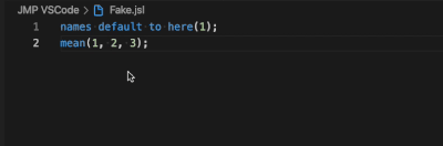

5.  Syntax Error Reporting (recently added)
I love this because it will look through all the files you have open and give them a big red title if any of them are bad. So if you have some nested include()s, you don't have to search through which file is actually the problem. Can't say enough how useful this ends up feeling.
