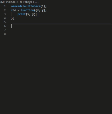

1. Syntax Highlighting - the most obvious thing we would need
2. Hover Over Descriptions
These are pulled from the scripting index of your JMP if you have it up. So if you use NewCustomFunction(), it will pull in functions from other add-ins as well.
3. Useful Snippets
The function snippet in this example also comes with Natural Docs syntax because all functions are better with good documentation. We've definitely found that our documentation has been a lot better since making this add-in.
4.  Running JSL
You can press Shift+Enter to run your selected text, or the whole file if nothing is selected. Or you can press Alt+Enter to run just the single line you're on. We went with the VSCode standard for running instead of Ctrl+R because it felt like it flowed better with other extensions. Also Ctrl+R is already taken. But don't worry, VSCode lets you edit pretty much everything, so you can set anything to any keybinding you like. It will freeze up your current instance of JMP a little, but if you press the "close VSCode server" button, you should be good again.

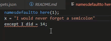

5.  Syntax Error Reporting (recently added)
I love this because it will look through all the files you have open and give them a big red title if any of them are bad. So if you have some nested include()s, you don't have to search through which file is actually the problem. Can't say enough how useful this ends up feeling.

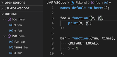

6. Symbol Outline
This is probably personally my most used feature. VSCode knows when you made a function, class, method, variable, whatever and will give you an outline of your current file. This is great because you can just surf the outline to look for what you want if the files are too big. Or you can just press Ctrl+O and type the variable and it will find it. The main reason this is better than Ctrl+F is that it will find ONLY where you assigned it. Not when you called it, or used the same name somewhere else in a different function ( it happens ). And again, you have full control on what types of variables you want in the outline. No functions? No problem.
