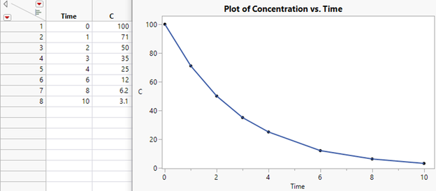

If you have X and Y coordinates of data, you can use the trapezoidal rule method. Below, I’ll work through an example of finding the area under a plasma concentration time curve. The data contains values of time (Time) and the associated concentration (C) of a drug in a subject’s blood at each time point. The content in this example comes from Nicole Jones’ piece in the Fall 1997 issue of JMPer Cable (see attached PDF copy).
Figure A illustrates the data and the plasma concentration time curve.

Figure A. Data and Plot of Concentration vs. Time
In this example, we use a variation of the Trapezoidal Rule. The first step is to divide the time curve into segments between each time point. Then, we’ll calculate the area in each segment. Finally, we’ll add the pieces together to obtain the total area under the curve.

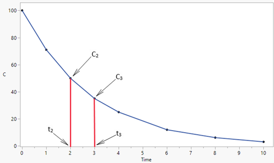

Consider each time segment to be a trapezoid, with its area given by the segment’s width and the average concentration within the segment width. Define ti as the ith time point (the unit of time is hours) and Ci as the drug concentration at the ith time point. The concentration between the second and third time period, denoted as AUC2,3 and illustrated in Figure B, is computed as:
Figure B. Concentration vs. Time in Segments

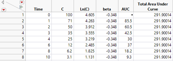

For this example, the steps are as follows:
1) Create a new column in the data table (let’s call it ln(C)) and use the Natural Log function in the calculator (under Transcendental functions) to compute the log of the concentration.
2) Create another new column (let’s call it beta) and use the calculator to compute the slope parameter of the regression of time on ln(C), as shown below.
The calculator formula to compute beta uses an assignment function to create temporary variables for the numerator (XY) and for the denominator (x2) of the slope computation. It then computes and assigns XY/x2 as beta.
The last step is to compute the total area under the curve by summing the areas of the individual segments and that of the final segment, computed as:
If you’d like to reuse the data table containing these formulas as a template, simply delete all the rows and save the empty table with its formulas preserved. To use the template, simply open it and paste your data into the columns Time and C. Rename the columns to suit your data if needed, and the preserved formulas will automatically use the new column names and compute the total AUC.
Figure C. Computed Slope Parameter and Total AUC
The data table shown in Figure C is attached to this post as well. It contains the necessary intermediate columns along with the total AUC calculation, and it includes all underlying formulas.
