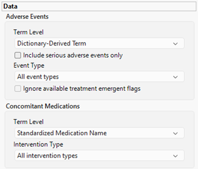

The dialog for Nearby Occurrences is shown in Figure 1. Users can refer to AEs or medications according to their individual coded names as specified by MedDRA or WHODrug Global, or they can refer to terms according to their reported text or higher level classification (e.g., High Level Term or Original Category for Medication). These designations become the “Terms of Interest” for Nearby Occurrences. Users can opt to explore all AEs or medications or subset to terms that occur during specific periods of the study (i.e., Pre-Treatment, On Treatment, Off Treatment Follow-up, Treatment Emergent).

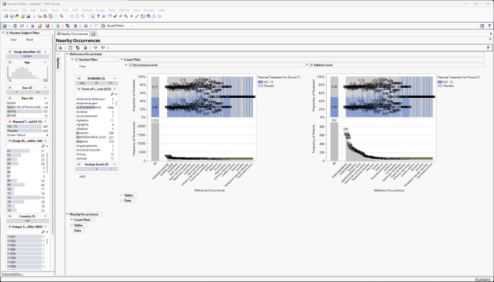

Running the report for the Nicardipine example provides the following output in Figure 2.
Figure 2. Nicardipine exampleFigure 2. Nicardipine example

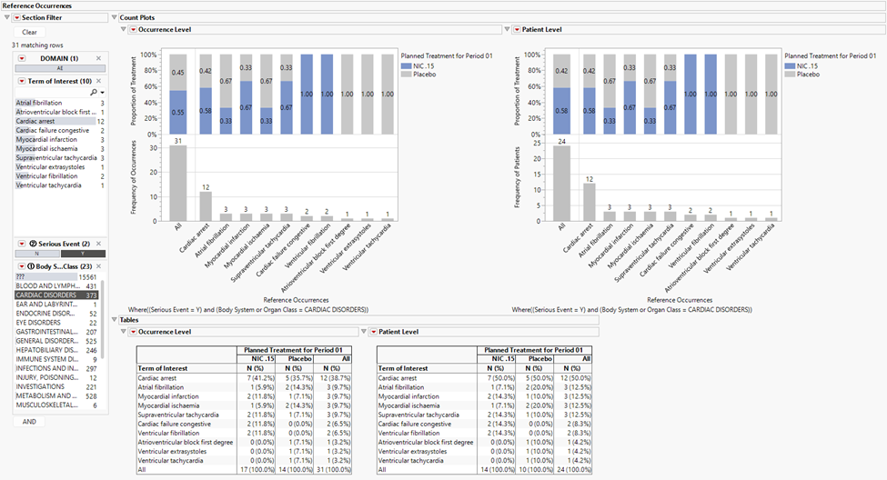

At this point, the output assumes all occurrences are of interest as reference occurrences (which isn’t particularly useful). However, suppose we are interested in Serious Adverse Events (SAEs) of the Cardiac Disorders System Organ Class (SOC). Selecting these terms in the data filter provides an occurrence level and patient level summary of the terms that have been selected (Figure 3). In this example, all of our reference occurrences are AEs. From the left count plot at the occurrence level in Figure 3, we can ascertain the following:
  1. There are 31 reference occurrences that are SAEs from the Cardiac Disorders SOC. Of these 31 occurrences, 55% and 45% of these events take place in patients in the NIC .15 and Placebo arms, respectively.
  2. The most common occurrence is cardiac arrest with 12 occurrences, with 58% and 42% in NIC .15 and Placebo, respectively.
  3. The least common Cardiac Disorders SAEs are atrioventricular block first degree, ventricular extrasystoles, and ventricular tachycardia with one occurrence each, which were all experienced in patients in the Placebo arm.
Figure 3. Reference occurrences: Cardiac Disorders SAEsFigure 3. Reference occurrences: Cardiac Disorders SAEs
From the right count plot at the patient level in Figure 3, we can ascertain the following:
  1. There were 24 patients that experienced Cardiac Disorders SAEs. Of these 24 patients, 58% and 42% are in the NIC .15 and Placebo arms, respectively.
  2. The frequencies of patients for each occurrence type (n = 12, 3, 3, 3, 3, 2, 2, 1, 1, 1) do not change from the occurrence level count plot, indicating that each occurrence type occurs in a different patient. Had the frequencies been higher for an occurrence type in the occurrence level plot, that would indicate that patients would have experienced more than one instance of an occurrence.
  3. The sum of the frequencies of the individual occurrences (n = 31) is greater than the number of patients (n = 24), indicating that some patients experienced multiple Cardiac Disorders SAEs.
The tabular summaries provided show the frequency and column percentage of each reference occurrence. For example, from the tables we can conclude that:
  1. 41.2% (7/17) and 35.7% (5/14) of the Cardiac Disorders SAEs experienced in the NIC .15 and Placebo arms, respectively, were cardiac arrest.
  2. 50.0% of the patients who experienced Cardiac Disorders SAEs in the NIC .15 (7/14) and Placebo (5/10) arms experienced a cardiac arrest.
The 31 reference occurrences are available for review by opening a Data outline box.

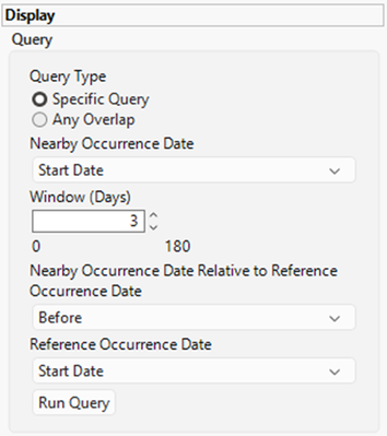

Let’s run the following query to identify nearby occurrences that start within three days before the start of the reference occurrences (Figure 5).

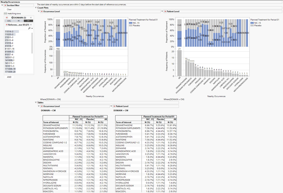

Clicking Run Query produces figures and tables in the Nearby Occurrences area of the output window. You can close the Reference Occurrences outline box to easily view this output. Recall that the Nicardipine trial has daily visits for approximately two weeks for a very severe disease. The initial output is extremely crowded, though when we subset to CM using the Data Filter, we get the following results in Figure 6.
Based on the results, the following conclusions are true:
  1. Occurrence level
    1. There are 192 CM occurrences that started within three days of the start date of at least one Cardiac Disorders SAE. Of these 192 CM occurrences, 54% and 46% of these CM occurrences take place in patients in the NIC .15 and Placebo arms, respectively.
    2. The most common nearby occurrence is dexamethasone with 22 occurrences, 50% in both NIC .15 and Placebo.
    3. Potassium supplements has 21 occurrences.
    4. Twenty-one out of 192 (10.9)% of all nearby CM occurrences were potassium supplements.
  2. Patient level
    1. Twenty-one of 24 patients have nearby CM occurrences for least one Cardiac Disorders SAE.
    2. Twelve patients took phenobarbital. Given there are 18 instances of phenobarbital at the occurrence level, some patients took it more than once in those three days). Eleven patients took potassium supplements. Given there are 21 instances at the occurrence level, some patients took it more than once in those three days).
    3. Twelve out of 21 (57.1%) patients had phenobarbital, two-thirds of whom were on NIC .15.
