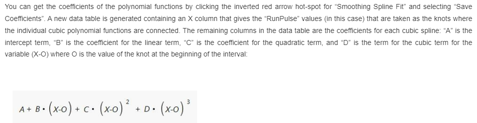

You can get the coefficients of the polynomial functions by clicking the inverted red arrow hot-spot for “Smoothing Spline Fit” and selecting “Save Coefficients”. A new data table is generated containing an X column that gives the “RunPulse” values (in this case) that are taken as the knots where the individual cubic polynomial functions are connected. The remaining columns in the data table are the coefficients for each cubic spline: “A” is the intercept term, “B” is the coefficient for the linear term, “C” is the coefficient for the quadratic term, and “D” is the term for the cubic term for the variable (X-O) where O is the value of the knot at the beginning of the interval:

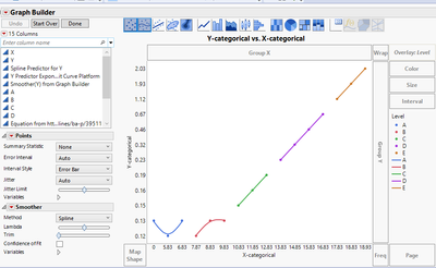

I see the option of cubic splines is available in JMP at graph builder when you test the moderating effect of a categorical variable on the effect of a categorical variable to the outcome which happens to be... you guessed it...also categorical variable. Does this make sense? Is that possible?
PatrickGiuliano
Staff

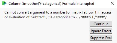

@triunk  You can "trick" JMP by specifying your modeling type as numeric (even when it's character) and in some cases this would work for you depending on your analytic situation (generally not recommended).  You are right in that the option still shows up in the area underneath the "Smoother" in JMP in the situation you are describing, however, JMP will not evaluate the formula for the spline fit because the data for your variables are non-numeric. Here's an example I generated:

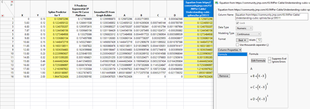

I wanted to add a little bit of clarification to this post to help clear up any potential confusion for how to evaluate the formula for the spline fit in this case. From the blog post above,
the value of "O" is the value of X at X = Xi-1 for every observation except for the first observation, where "O" is the value of X (causing the B, C and D terms to effectively zero out).  To illustrate this, the following shows how the formula can be evaluated in JMP using column formulas in the context of a simple example:
Hope this helps!
