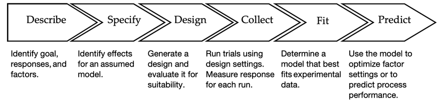

Tom will cover a six-step framework for creating a successful designed experiment that can be run in your work environment. The steps?
  1. Describe the goal, factors and responses.
  2. Specify an assumed model that you believe adequately describes the physical situation.
  3. Generate and evaluate a design that is consistent with your assumed model.
  4. Incorporate trial run measurements into the design.
  5. Determine the best model (often a subset of the proposed model).
  6. Use model results to optimize factor settings and/or predict performance.
