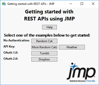

This is what the final product looks like:
I did research and compiled it into the Help button at the top, for those who want more description of the different authentication methods. It provides a description of each type of authentication we will tackle.

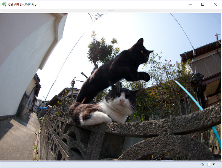

Next was the fun part. I found different APIs to access to utilize within my add-in. The CAT API is my personal favorite, so I used it twice (once for without authentication and once for with). Each time you click Send, a new cat pops up!
After I got the Cat API working, I found several other good examples and included the ones I like best in the add-in.

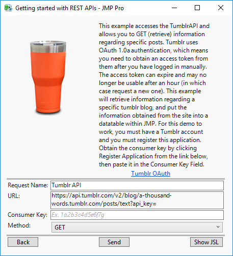

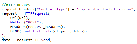

I especially enjoyed working on the Tumblr example, since it retrieves so much information (the entire tumblr blog). I wasn’t able to make the information that’s retrieved look that pretty, but I think it still does a good job. For anyone wishing to retrieve information on a different Tumblr post, they can switch out the Tumblr blog address in the JSL script here:

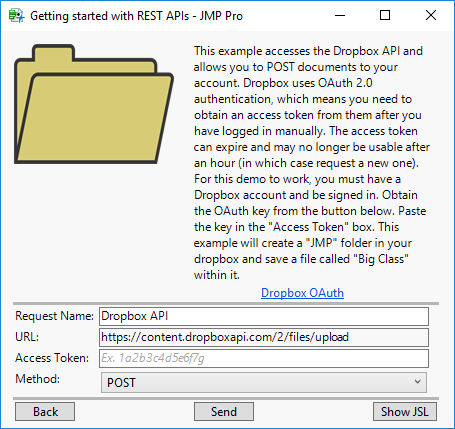

The last example was something special. Dropbox is an example that one of the other principal developers had already worked on. I wanted to integrate this example into my add-in to try and make it as user-friendly as possible so that anyone without programming experience could use it. The fact that it can remotely upload a file and folder with the click of a button through JMP still astounds me.
