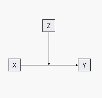

The Structural Equation Modeling (SEM) platform in JMP Pro enables us to model complex patterns of relationships among many variables. Often, these complex patterns involve interactions (also known as moderation), when one variable influences the strength of the relation between two other variables. Figure 1 shows a conceptual model of an interaction.
Figure 1. Conceptual diagram of an interaction.

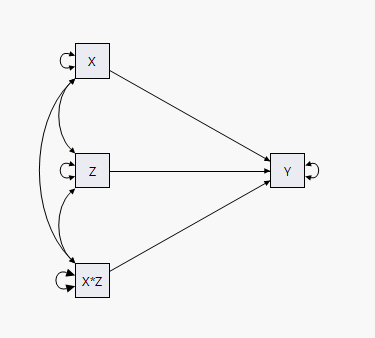

Figure 2 shows the corresponding statistical model of the interaction. Note that the predictor (X), the moderator (Z), and their product term (X*Z) are all predictors of the outcome (Y).
Figure 2. Statistical diagram of an interaction.

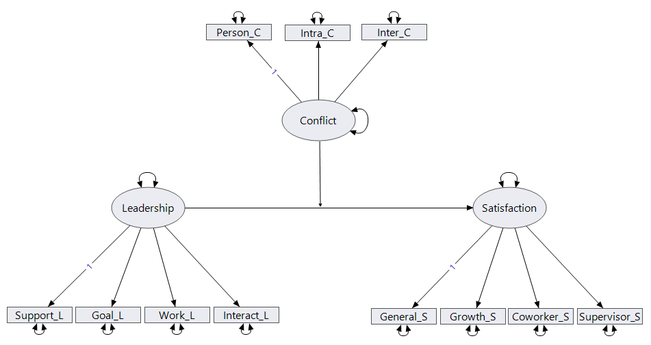

We hypothesize that workplace leadership and conflict have an interactive effect on job satisfaction. Specifically, when workplace conflict is higher, the effect of leadership on job satisfaction is weaker. The conceptual model is shown in Figure 4. However, this is not a valid statistical model that can be specified in the SEM platform (we can’t have arrows pointing at other arrows!). How do we specify this as a statistical model?
Figure 4. Conceptual diagram of the latent interaction model.

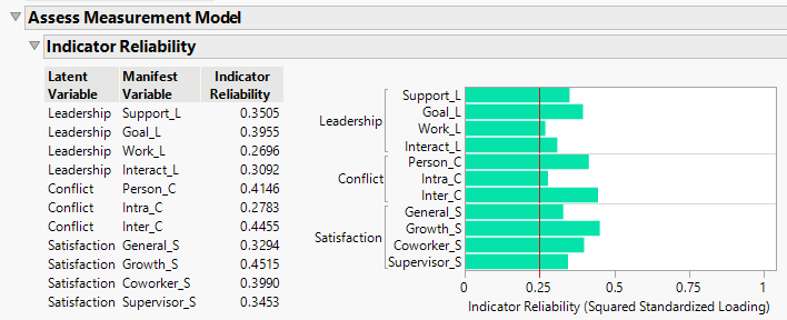

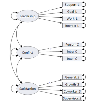

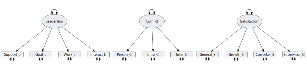

To decide how to create our parcel, and then our matched pairs, let’s fit a three-factor CFA to these data (using uncentered variables for now), then select Assess Measurement Model from the red triangle menu. We’ll focus on the Indicator Reliability section of the report.
Figure 5. Three-factor CFA used to determine indicator reliability.
Figure 6. Assess Measurement Model output from the three-factor CFA.
Work_L and Interact_L are the least reliable indicators of Leadership, so we’ll create a parcel of these two items to strengthen reliability. In the data table, select these two variables, then right-click > New Formula Column > Combine > Average. Then, center the averaged variable; we’ll use the centered variable later when we fit the latent interaction model.

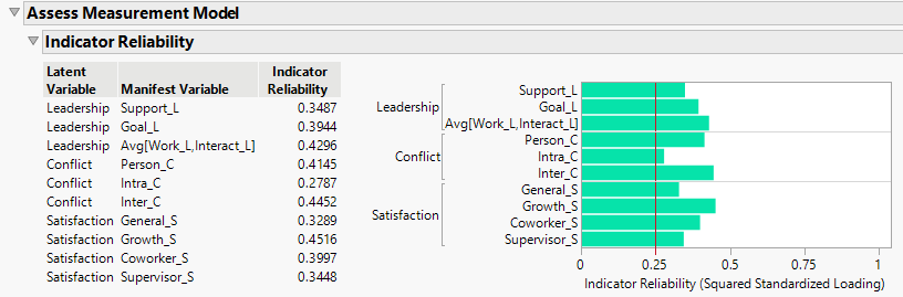

Next, let’s rerun the three-factor CFA using the parcel in place of Work_L and Interact_L (still using uncentered variables for now).
Figure 7. Three-factor CFA with parcel.
Figure 8. Assess Measurement Model output from three-factor CFA with parcel.
From here, we can create our matched pairs according to indicator reliability. The parcel is the most reliable indicator of Leadership, and Inter_C is the most reliable indicator of Conflict. We’ll multiply these two columns to create a product term. The next most reliable indicators of Leadership and Conflict, respectively, are Goal_L and Person_C, so we’ll multiply these columns. Finally, we’ll multiply Support_L and Intra_C.

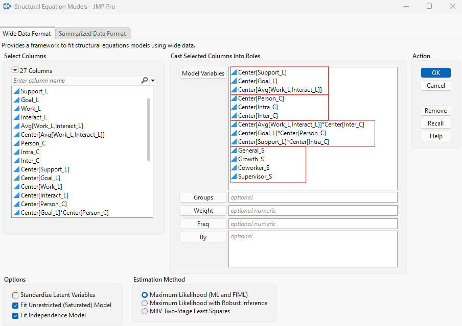

Now we’re ready to launch the SEM platform. On launch, include:
(1) The mean-centered indicators of the predictor Leadership.
(2) The mean-centered indicators of the moderator Conflict.
(3) Their product terms.
(4) The indicators of the outcome (these can be uncentered).
The figure below shows the SEM launch window with boxes around each variable set (1), (2), (3), and (4).
Figure 9. SEM launch window for the latent interaction model.

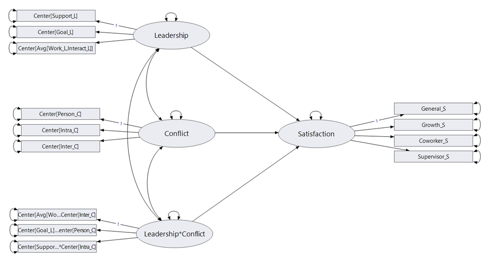

To specify the model, follow these steps:

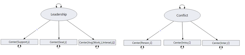

  1. Specify latent variables and latent interactions. For the latent predictor and moderator, use centered indicators created in preprocessing. For latent interactions, use the product variables created in preprocessing.
  2. Add regression paths from the latent predictor, the latent moderator, and their latent interaction to the latent outcome.
  3. Allow the latent predictor, latent moderator, and their latent interaction to covary.
Figure 10. Specification of the latent predictor, latent moderator, and latent interaction term.
Figure 11. Full specification of the latent interaction model.
Interpreting output
After fitting the full model, we can begin by assessing model-data fit, which the Model Comparison table suggests is good (CFI = 1, RMSEA = 0, SRMR = .0327). Next, examine the regression estimates shown below. The coefficient for the product term (Leadership*Conflict) is negative, implying that as conflict increases, the relation between leadership and job satisfaction weakens. This is consistent with our hypothesis; however, the interaction is not statistically significant.
