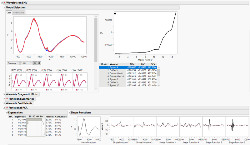

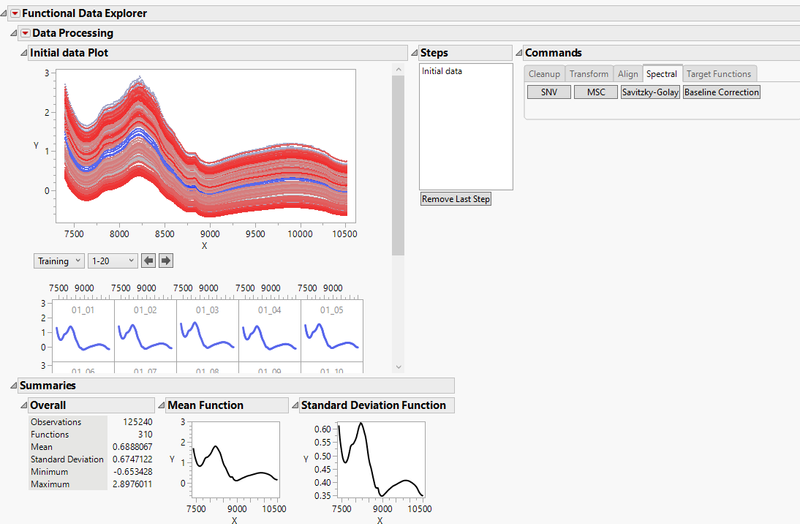

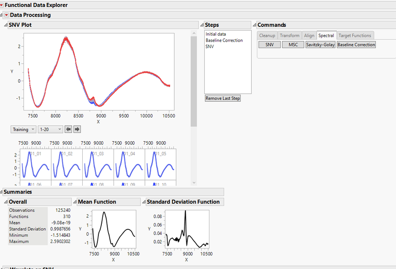

Preprocessing of Near IR data using the newer tools in FDE. The bottom image shows the new Wavelet modeling functionality that is built into FDE.
