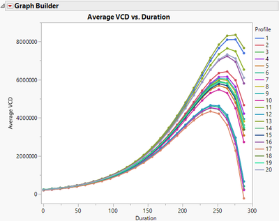

Functional data are collected over a continuum. The object of interest is an entire curve, not just one value from a curve. A sample of observations is a collection of multiple functions, as shown in Figure 1.
Figure 1. Multiple curves in a set of data.

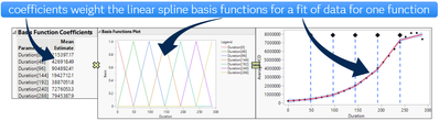

The models used to extract the shape information are linear combinations of basis functions. That is, the model is the sum of coefficients times basis functions, as shown in Figure 2.
Figure 2. Basis function expansion modeling.

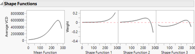

The platform provides graphs to help interpret the fitted models, starting with the shape functions, as shown in Figure 3.
Figure 3. Shape functions.
These shape functions can be used to understand the curve-to-curve variation in the data around the mean. They indicate the shape features of the data curves. The basis function model can be rewritten as a linear combination of shape functions. The coefficients of the shape functions are the functional principal component scores. These functional principal components are new, scalar variables that contain the shape information in the data. They are uncorrelated with each other and can be used as responses or factors in other statistical analyses.

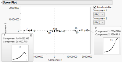

Plotting the functional principal components can help with model interpretation. With JMP’s hover graphlets, it’s easy to see the differences in the data curves across the values of the functional principal components, as shown in Figure 4.
Figure 4. Score plots comparing functional principal component values for two curves.

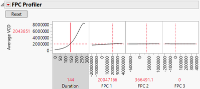

The Functional Principal Components (FPC) Profiler helps interpret how changing the coefficients of the shape functions changes the predicted shape of the curve, as shown in Figure 5.
Figure 5. FPC Profiler for interactively approximating the curve using FPC coefficients.

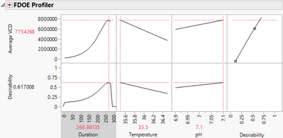

A linear combination of the shape functions can be used to approximate each function. The coefficients of the shape functions in the linear combination are the functional principal components. Saving the functional principal components gives new scalar variables than can then be analyzed using any ordinary statistical analysis, including as responses in a designed experiment, as predictors in a statistical model, control charts, gauge studies, cluster analysis, among many other techniques, as shown in Figure 6.
Figure 6. Optimization in the FDOE Profiler using a functional DOE model for the curve response.

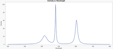

Wavelet basis function models work very well to model data of any shape, and are especially good at fitting data with with sharp peaks, such as curves found in spectral analysis, as shown in Figure 7. Their main weakness is that they need at least 10 observations per function, so are not suitable for modeling short functions.
Figure 7. Simulated spectral data.

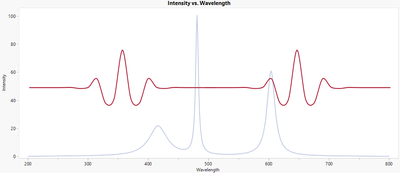

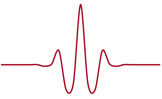

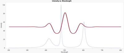

Wavelets are functions which oscillate above and below the X axis, so they integrate to zero. They decay quickly on the edges, as shown in Figure 8.
Figure 8. Example wavelet function.

The model consists of the sum of two linear combinations. The first is a linear combination of scaling functions and contains no shape information. The second is a linear combination of coefficients times basis functions. The first part of this linear combination is a coefficient times the wavelet stretched to the domain of the function, as shown in Figure 9.
Figure 9. Wavelet applied to the whole domain.

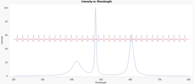

Next, the domain is cut into fourths, then eighths, and so on, as shown in Figure 11.
Figure 11. Wavelet applied to 25 segments of the domain.
