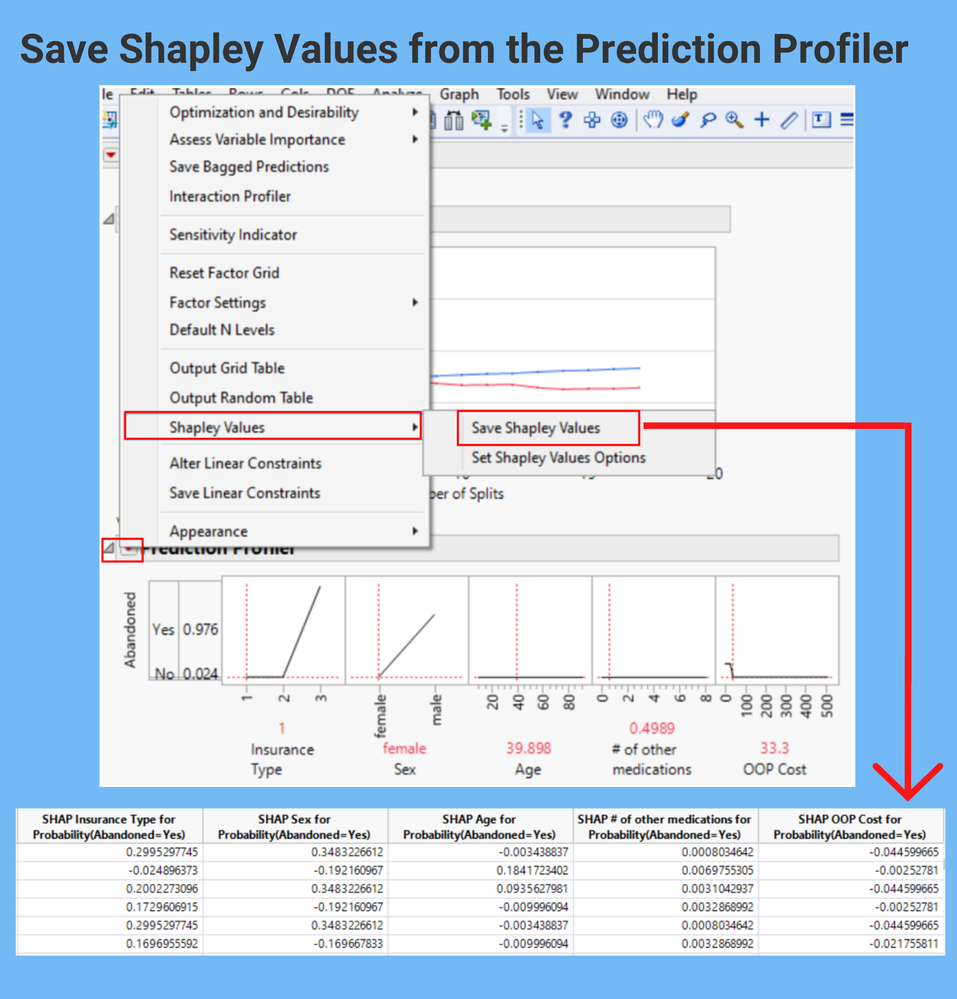

How can you get started exploring this new feature? It’s simple. Add the Profiler to your model results and select the option for Save Shapley Values. This will save individual columns to your data table for each factor/response level combination.
