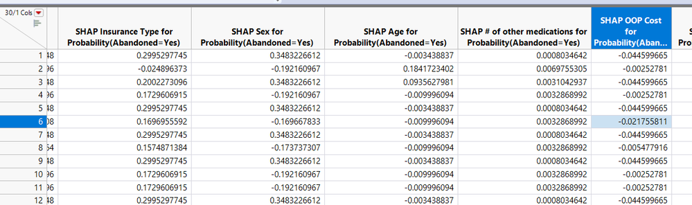

How can you get started exploring this new feature? It’s simple. Add the Profiler to your model results and select the option for Save Shapley Values. This will save individual columns to your data table for each factor/response level combination.

lala
Level IX
Can this example directly give the final analysis result using the decision tree model?
Thanks!
lala
Level IX
I found the resulting action steps in the picture.
But what if you could do this directly with JSL?
