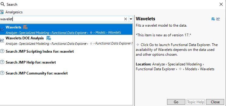

gail_massari
Community Manager
Searching documentation isn't always useful & seldom fun. Gotta brag- New #JMP 17 search goes beyond words and definitions. It describes menu paths (actions and steps) to use the analysis in JMP. See how to find a way to analyze wavelets (new JMP Pro 17 way to analyze spectral data) & more. wavelet search.JPG
