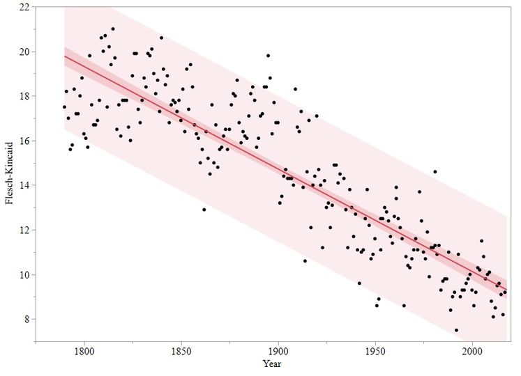

With a simple regression model, we see a generally declining relationship between Flesch-Kincaid grade level and year. If one were to look at the Linear Fit results (which I'm not showing), we would see the Summary of Fit, Analysis of Variance, Lack of Fit, and Parameter Estimates. At first glance, our fit looks decent, it has an R2 of 0.77, the ANOVA table shows a statsitical significant model (95% level). However, the points are scattered all over so examining the quality of the fit is necessary. Additionally, the regression model is Flesch-Kincaid = 101.96665 - 0.0459147*Year, which will obviously only work for certain range since this will go negative eventually. An example of extrapolating out too far: if we extrapolate out to the year 2974, when the movie Idiocracy was set, President Camacho's speech has a grade level of 4.0 years of education, but our model would predict an impossible -34 grade level.
General Trend Between Year and Flesch-Kincaid Grade LevelGeneral Trend Between Year and Flesch-Kincaid Grade Level
In the output, we also see a lack of fit table since we have some repeated values (a few years had multiple State of the Union Addresses). But since very few years had this occurance, e.g., 1790 and 1980, we thus can't learn much from this table. So we'll ignore this table.
In order to answer our question – What will the grade level be of Trump's Jan. 30 State of the Union speech? – we will consider both confidence intervals (which are rather tight since it's concerned with the data today) and prediction intervals (which are wider since they are concerned with future values). For a regression analysis, we really want to look at the residuals to see if we have noticeable issues in violating various regression assumptions, e.g., normality.

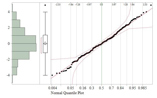

Many assumptions of regression models and residuals (the error in a regression model, i.e., the distance between the predicted line and each observation) involve normality. We can examine this by considering a normal quantile plot (a normal probability plot in many books). This can be found by selecting Analyze > Distribution in JMP and selecting the residual column. While the histogram looks normal, we can't trust this completely (see 7.2 Testing for Normality of my book for examples and discussion). So we'll want to select a normal quantile to better examine the normality. We can do this by clicking on the red triangle and selecting Normal Quantile Plot, which results in the following figure. Of interest is that the residuals all follow the line, are not outside the confidence interval and show no apparent shape. So, we're good as far as the normality assumption goes.
Residual Normal Quantile PlotResidual Normal Quantile PlotOther issues can exist with outliers pulling the regression line, non-constant variance problems and etc. There are many ways to examine residuals for such issues; I'm a big fan of standardized residuals because we can both look at the shape of the residuals while getting an impression of what points might be outliers. Standardized residuals are computed by dividing each residual value by the standard deviations, which we can approximate as the square root of the ANOVA model's MSE. For our data, we would create a column with the following formula.

With some confidence in the quality of our model, we can now proceed to the question we care about: "What is the Trevor prediction for the grade-level of Trump's Jan. 30 State of the Union Address?" We can use prediction and confidence intervals for this purpose. Visually, we see that the confidence interval is rather close to the regression line, with the prediction inverval covering a much larger area outside of this. This is expected since the prediction interval assumes more uncertainty.
Regression Model with Both 95% Confidence and 95% Prediction IntervalsRegression Model with Both 95% Confidence and 95% Prediction Intervals
For the value we care about, we need to look in the data table at the year 2018. We have a predicted value of 9.31 for the 2018 State of the Union Address. This is therefore my prediction for the upcoming Jan. 30 speech.
However, this is not all; we can't stop at a single number, and we should include a bound on this. The prediction interval at 2018 is very wide (6.0 to 12.6), as seen in the figure above. Instead of using this very wide and useless interval, let's look at the confidence interval, which is 8.9 to 9.7.
Thus, my prediction for the Jan. 30 State of the Union is a Flesch-Kincaid grade level of 9.31+-0.4. Now let's see how right (or wrong) I am in a few weeks. Do you have any predictions you want to share?
