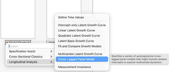

The SEM platform has a useful model shortcut to specify autoregressive models under the Longitudinal Analysis submenu (look for Cross-Lagged Panel Model).

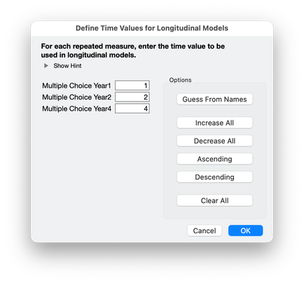

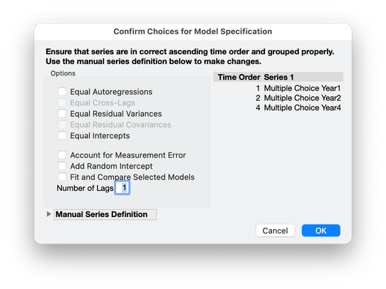

The model shortcut prompts users to input the time value at which each repeated measure was obtained. These values are critical for the SEM platform to know how to specify the model (otherwise, which variable comes before which?). A great convention is to include time values at the end of each variable name, which enables use of the Guess From Names button in the initial pop-up menu.
After defining time values, the next window shows the SEM platform’s interpretation of the repeated measures. We must make sure the times and order are correct in the table. We also have options to set equality constraints, add latent variables to account for measurement error, add random intercepts, etc. Here, we’re going to uncheck all the options and click OK.

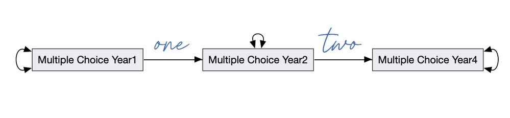

The resulting model is technically correct; but remember that in many applications, we want to test the equality of the autoregressive effects. The current model specification doesn’t allow us to do that because Year 1 --> Year 2 is not the same as Year 2 --> Year 4 (the first lag is one year but the second is two years).

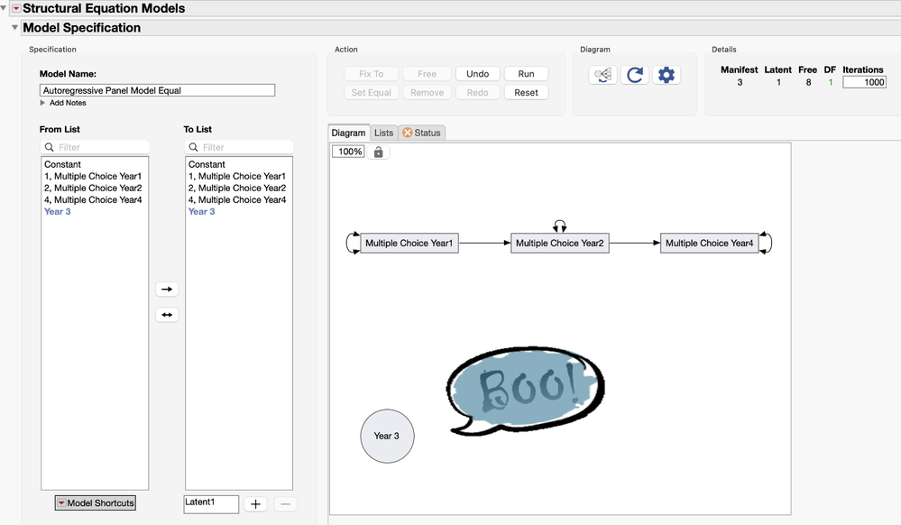

To specify a phantom variable, we need to select any one manifest variable in the To List, name the phantom variable intuitively, and click the + button. The latent variable will show up in the path diagram, but we need to remove its factor loading that’s linking it to the manifest variable (select the loading in the diagram and click Remove in the action buttons). We also have to do something about its variance; for now, we’ll fix it to zero (select the variance in the diagram and click Fix To or Remove in the action buttons). Finally, we have a true phantom variable in our model:

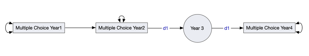

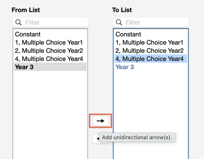

Now we need to treat the phantom variable as if it was a real variable in our model. It will act as a place holder for the missing Year 3 data and will allow us to get accurate year-to-year autoregressive effects. To do this, select the Year 2 --> Year 4 regression effect in the diagram and click Remove. Then, select the Year 2 variable in the From List, the Year 3 phantom variable in the To List, and click the one-headed arrow. Repeat these steps to connect the phantom variable to the Year 4 variable.

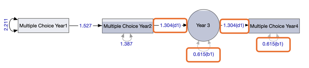

Now, each regression effect represents the same time lag. However, the model is not quite ready to be fitted yet. We still need to add equality constraints to identify the model. For our simplest model, we’ll just set equality constraints on the two paths linked to the phantom variable (this is the minimum needed to identify the model). Select the paths and click Set Equal in the action buttons:

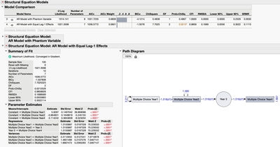

Now click Run to fit the model. We can examine the results, but recall that our goal is to test whether autoregressive effects are equal across time. Thus, we need to fit another model where we impose equality constraints on all autoregressive effects. Select all three autoregressive effects and click Set Equal followed by Run to fit the second model:

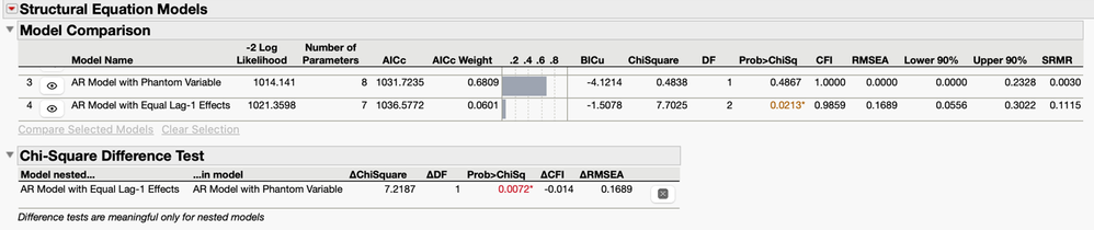

Before examining the results of the second model, let’s first determine which of the two models fits best. Select both models in the Model Comparison table and click the Compare Selected Models button below the table. The chi-square difference test answers our key question:

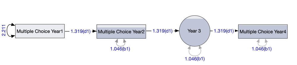

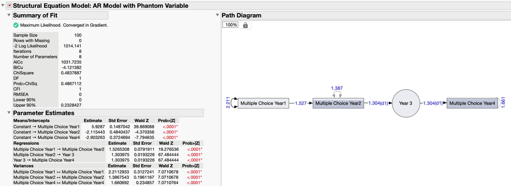

In this example, the significant difference in chi-square suggests there’s a significant increase in model misfit when we place equality constraints across all autoregressive effects. In other words, the Year 1 --> Year 2 effect is not equal to Year 2 --> Year 3 or Year 3 --> Year 4. Results from the first model are the ones we ought to interpret.
For every unit increase in Year 1 scores, we expect a 1.527 unit increase in Year 2 scores. This increase is significantly greater than the increases for Year 2 --> Year 3 and Year 3 --> Year 4, which are 1.304 units. Importantly, we don’t have data to test empirically the equality of effects from Year 2 --> Year 3 and Year 3 --> Year 4. However, the phantom variable helped us estimate the autoregressive effects in the proper units by acting as a place holder for Year 3.

In some cases, one might also want to test the equality of residual variances over time. This is possible by specifying residual variances for each phantom variable (other variables already have residual variances), and setting appropriate equality constraints across time. In our example, the minimum number of equality constraints required so the phantom variable can have a residual variance is displayed below.
A model with equality constraints across all residual variances also requires equality constraints in all autoregressive effects.
