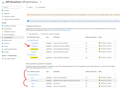

I've tried option 2 but if Sites.Read.All is there then Sites.Selected does not restrict access to other sites.
I've made the app, added the permissions in the article.  I've restricted the app using PowerShell.  Onedrive and other urls appear available.
If I remove Sites.Read.All from the permissions, I get prompted for Consent.
Is there a way to remove Sitese.Read.All and not deal with consent?

@computerhabit Thank you for your comment! If you wish to restrict the level of access that the SharePoint Data Connector will have, then you should only use the Sites.Selected API permission. There is currently no way to bypass the consent for Sites.Selected alone since that requires admin consent and approval for the selected Site collections. I included Sites.Read.All so that the connector can access to all of the Sites that the user has permissions to access. You can read more about the SharePoint Site API permissions here. I hope this helps.

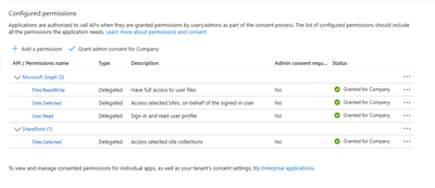

@computerhabit Your issue here is most likely that your app is requesting "Application" level API permissions whereas you should request "Delegated" API permissions. Try to change Sites.Selected to "Delegated" and then try again. As long as the API permission is "Delegated" and has been approved, that is what you should need. Please let me know if this works so I can assist further.

Hello,
I tried the following settings, and it still asks for admin consent.

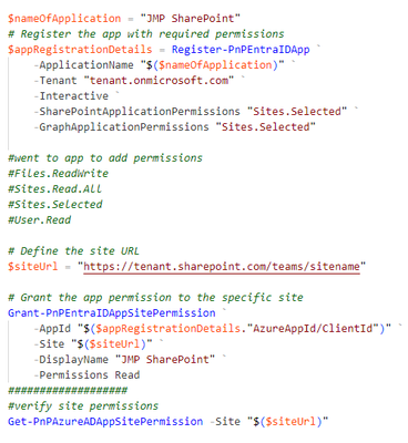

@computerhabit You most likely need to add permissions to your app that let you access the Site collections that you wish to access. Reference this article to view how to add these permissions in PowerShell. Please let me know if this helps.

Thank you for your continued support.  Here is an example of the applying of the application to the site.
I did give it only read but that seemed appropriate.  As you can see below the permission exists.
