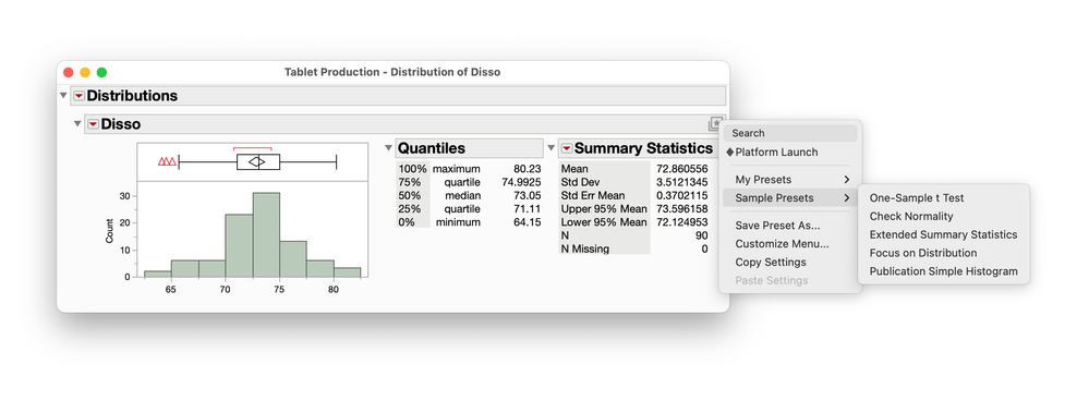

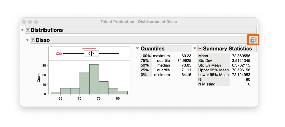

I’ll launch Distribution for the Disso column. Notice that there is a new icon on the right-hand side of the platform. That's the Platform Preset menu.
First, let’s apply the sample preset named “Check Normality.” To do this, click on the Platform Preset icon > Sample Presets > Check Normality.

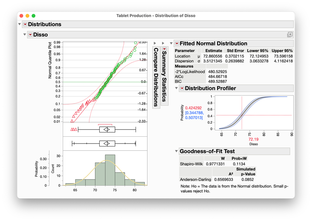

After selecting this preset, the platform will reconfigure itself to recall the settings and customizations that were made when the preset was created.
For this particular preset, many red triangle options were turned on, while others were turned off, and two outline boxes were closed. If you had to create this output from scratch every day, it would take a lot of time. With a Platform Preset, we can jump right to the end.

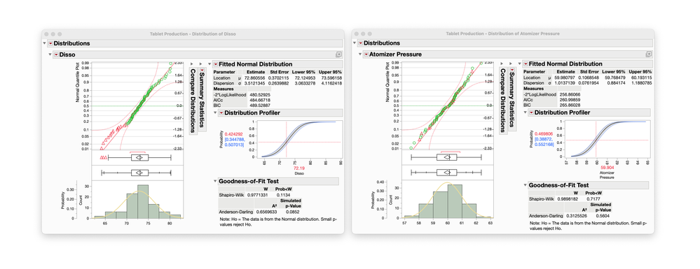

Remember, Platform Presets are not data table- or column-specific, which means I can use the same preset with another column in this or any other table. Let’s try it with Atomizer Pressure.
When we click the Platform Presets menu, we can either return to the Sample Presets submenu or select the top item in the main list, which will be the most recently applied preset for that platform. Having a history of the presets you have applied makes it easy to apply the same present in different windows.
After applying the preset, our output looks identical for both the Disso and Atomizer Pressure columns. As someone who values consistency in addition to efficiency, I love that I can use Platform Presets to get identical output day after day without any extra work.

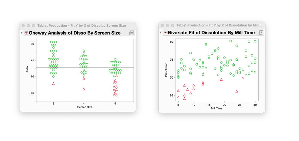

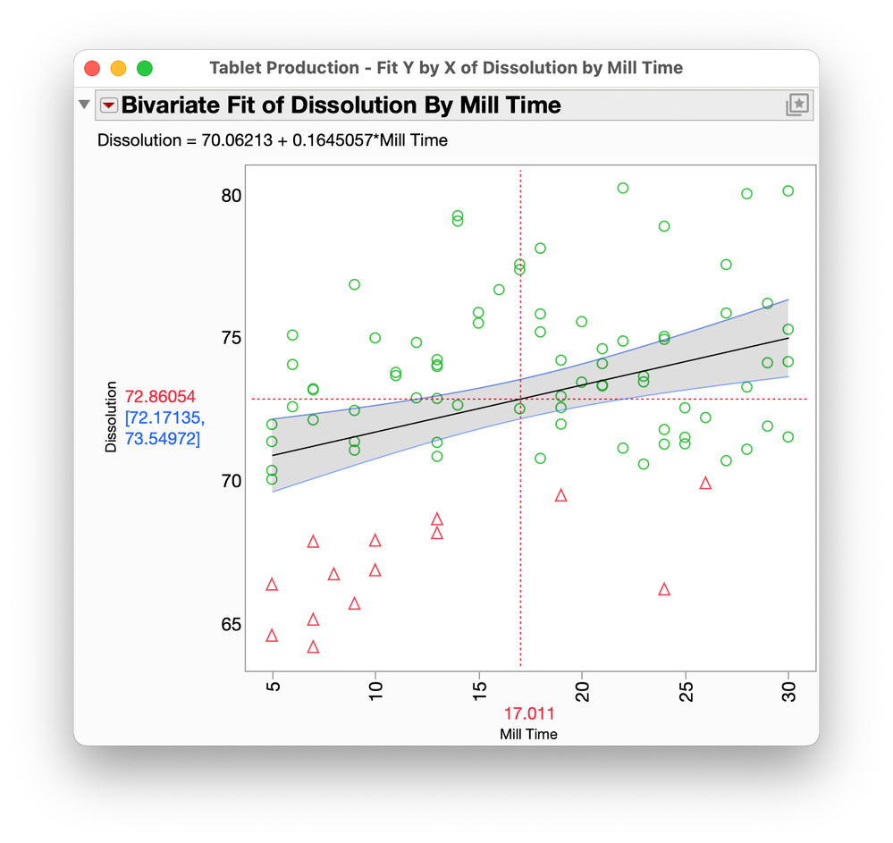

To see this, let’s explore another platform, Fit Y by X. I’ll create two different analyses: Disso vs Screen Size (which is categorical), and Disso vs Mill Time (which is continuous).

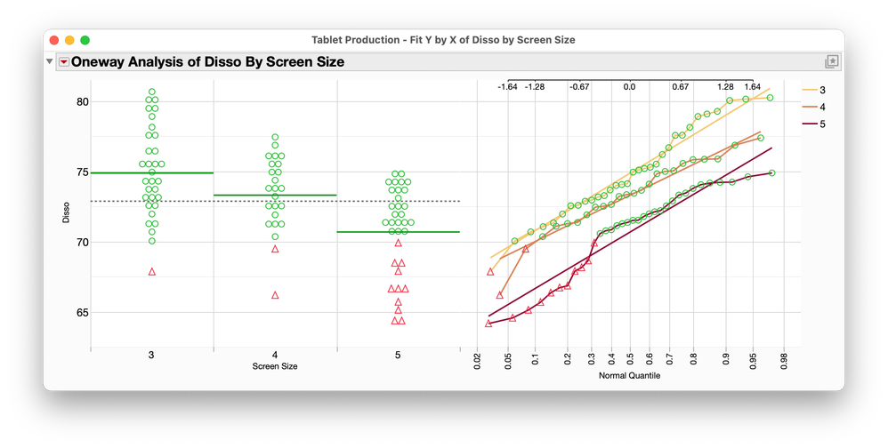

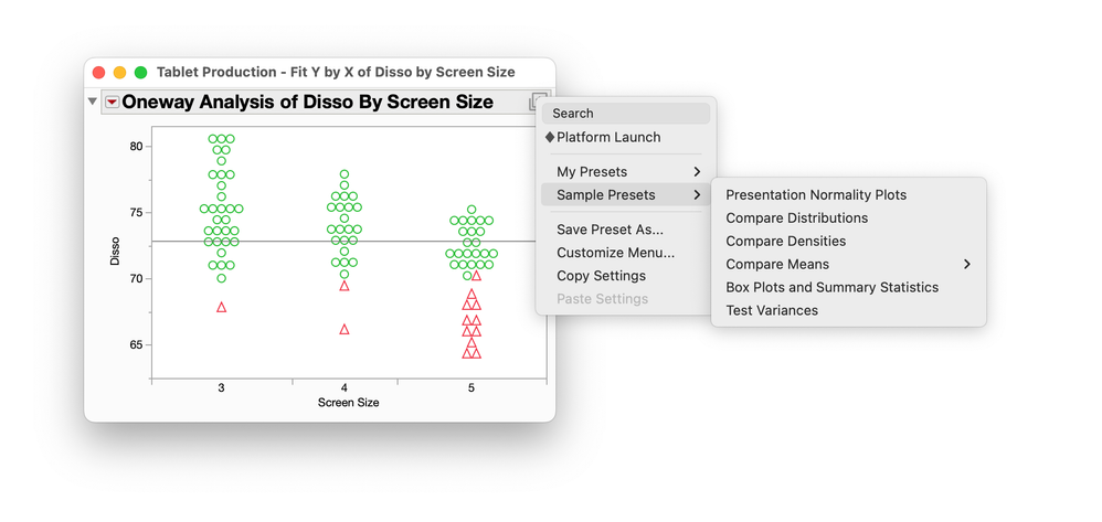

For Screen Size, we have the default One Way output, which is the domain of ANOVA, t-tests, etc. For Mill Time, we see the default Bivariate output, which is the domain of regression and other similar techniques. Let’s apply some sample presets.
For Screen Size, I apply “Presentation Normality Plots.”
Once applied, the platform reconfigures to the stored settings:

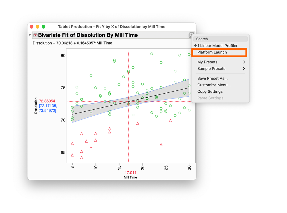

Now let’s see how to make your own Platform Presets. First, I go back to the Platform Presets menu and then select “Platform Launch” to return the platform to the initial state when launched. This is a quick way to revert the platform if you want to start over.

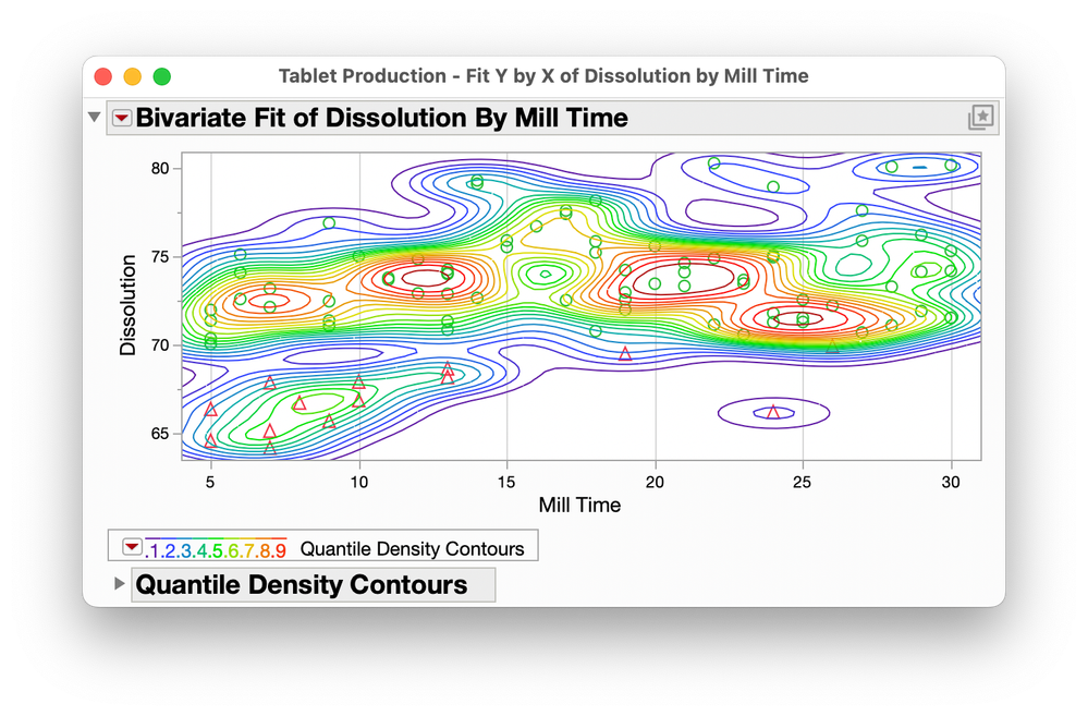

Now, let’s make some changes that we might want to store as a preset. I’m going to do the following, but feel free to make any changes you want at this step:
  1. Resize the graph to be wider than usual.
  2. Turn on gridlines for the X axis
  3. Make the fonts larger for the X and Y axis labels.
  4. Turn on Nonparametic Densities (red triangle > Nonpar Density).
  5. Close the outline box for Quantile Density Contours.
At this point, my output looks like this:
Assuming that we’re happy with this output, we’re now ready to save our preset.

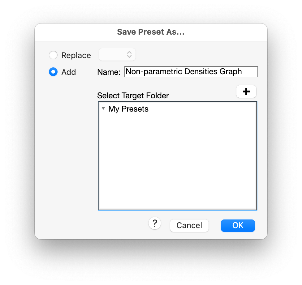

Go to the preset menu and select Save Preset As…. I’ll give it a descriptive name, Non-parametric Densities Graph, and click OK.
This platform preset is now available to use under the My Preset menu; it is available any time I use the Fit Y by X platform with these types of columns.

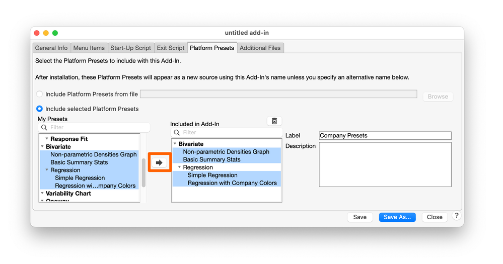

If you intend to deploy presets across your organization and don't want those presets to be intermingled with user presets, creating a Platform Preset add-in is the right way to go. To begin, go to File > New > New Add In.
First, provide a name and ID for the add-in.
Next, select the new Platform Presets tab, highlight the presets you wish to include, and click the right arrow button to include them in this add-in. If you wish to provide a special label for these presets, you can do that here. That label will be used as the source name in Platform Preset menus. If you do not specify a label, the Add-In ID you specified earlier will be used, which ordinarily is not as descriptive as you might want to be, so my recommendation is to always supply a label.
Once you are done, click Save/Save As to complete this add-in.
