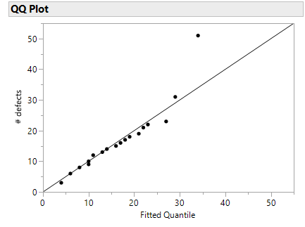

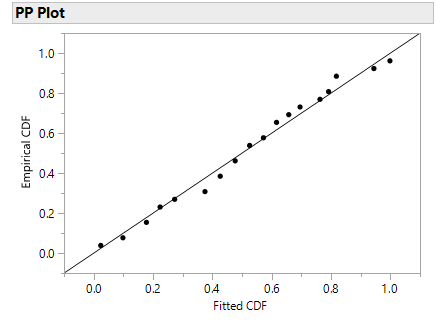

The diagnostic plot has been replaced with two new plots (QQ and PP plots). The quantile-quantile (QQ) plot shows the relationship between the observations and the quantiles obtained using the estimated parameters. The percentile-percentile (PP) plot shows the relationship between the empirical cumulative distribution function (CDF) and the fitted CDF obtained using the estimated parameters.

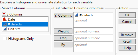

Select Analyze->Distribution.  Specify # defects as Y, Columns and click OK.
From the red triangle next to # defects, select Discrete Fit->Fit Negative Binomial. From the red triangle next to Fitted Negative Binomial Distribution, choose QQ Plot and PP Plot.
For the QQ Plot, most observations fall close to the diagonal line. The last point is questionable. If the two sets (fitted negative binomial quantiles and the # defects) come from the same distribution, the points should fall approximately along the reference line. The PP plot has a similar interpretation. The points in the PP plot fall approximately along the reference line indicating that the Negative Binomial fitted CDF and the empirical CDF come from a population with the same distribution.

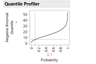

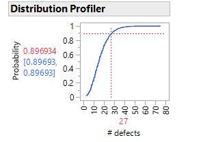

Two Profilers have been added. The Distribution Profiler is a Prediction Profiler of the cumulative distribution function (CDF). The Quantile Profiler is a prediction profiler of the quantile function.
Using the previous example, choose Distribution Profiler and Quantile Profiler from the red triangle menu next to Fitted Negative Binomial Distribution.
If the data follow the fitted negative binomial distribution, the Distribution Profiler shows that the probability of getting 27 defects or fewer is .896934 (~90%). The Quantile Profiler gives the inverse of the Distribution Profiler. For this example, the probability that we get seven or fewer defects is .1 or 10%. The Profilers are interactive. You can move the slider around to determine what the probability would be for various numbers of defects.

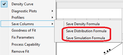

Two new save column features have been added. Save Distribution Formula saves a column to the data table that contains the cumulative distribution function (CDF) formula computed using the estimated parameter values. Save Simulation Formula saves a column to the data table that contains a formula that generates simulated values using the estimated parameters. This column can be used in the Simulate utility.
