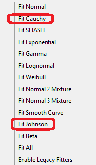

You can now fit a Negative Binomial distribution (equivalent to the Gamma-Poisson distribution), a Cauchy distribution, a ZI (zero-inflated) Poisson distribution, and a ZI (zero-inflated) Negative Binomial distribution. The Johnson fits are now a single command that fits the best-fitting distribution from the Johnson system of distributions. This Johnson fitting method is the same method (quantile matching) used in the Process Capability platform. This method is more stable and faster than maximum likelihood.

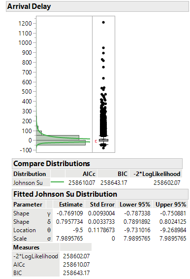

To see an example of the new Johnson fitter, open Airline Delays.jmp found in the sample data folder.
Open("$SAMPLE_DATA/Airline Delays.jmp");
Select Analyze->Distribution.  Specify Arrival Delay as Y, Columns and click OK.
Click on the red triangle next to Arrival Delay and select Continuous Fit->Fit Johnson. The best fit from the family of Johnson distributions for this data is the Johnson Su Distribution.
