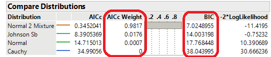

After fits have been selected, a Compare Distributions report is added. In previous versions of JMP, you only got a Compare Distributions report when using the All option under Continuous Fit. Now, you get this report after selecting any distribution. As distributions are added to the report, they are also added to the Compare Distributions report.  Additionally, AICc Weight (corrected and weighted Akaike's Information Criterion) and BIC (Bayesian Information Criterion) has been added to this report. These statistics were already present in other parts of JMP such as Model Comparison, and they have now been added to the Distribution platform.

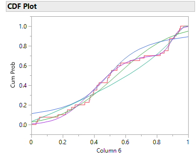

In addition to the Compare Distributions report and the overlaid histograms (available in previous version of JMP), CDF plots can be used to compare distributional fits. Adding the CDF plot to the report superimposes the CDFs for the fitted distributions onto the empirical CDF.

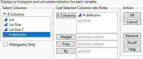

Select Analyze->Distribution. Specify # defective as Y, Columns and click OK.

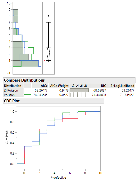

Since we are dealing with count data, let’s fit the Poisson distribution and the ZI Poisson distribution to see how they compare. Hold down the Alt key (Option key on the mac) and click on the red triangle. Check the box for CDF Plot, Fit Poisson, and Fit ZI Poisson. Click OK.
The histogram shows us that the blue line more closely follows the data. In the Compare Distributions report, we see that the blue line is for the ZI Poisson distribution. The Compare Distributions report is initially sorted by AICc in ascending order. The ZI Poisson distribution has a smaller AICc indicating a better fit. The CDF plot shows that the blue line (ZI Poisson) more closely follows the red line (empirical CDF) indicating a better fit.
