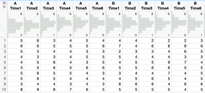

Suppose we have 10 short, stationary, time series measuring 10 constructs of interest. Let’s label each of these constructs A through J, and we’ll use “Time t” to denote the time at which they were measured. We’re assuming our sample was assessed at the same time points on six repeated occasions, and we have some missing data, as is often the case with longitudinal designs.
A screenshot of our data table showing repeated measures of the first two constructs looks like this:

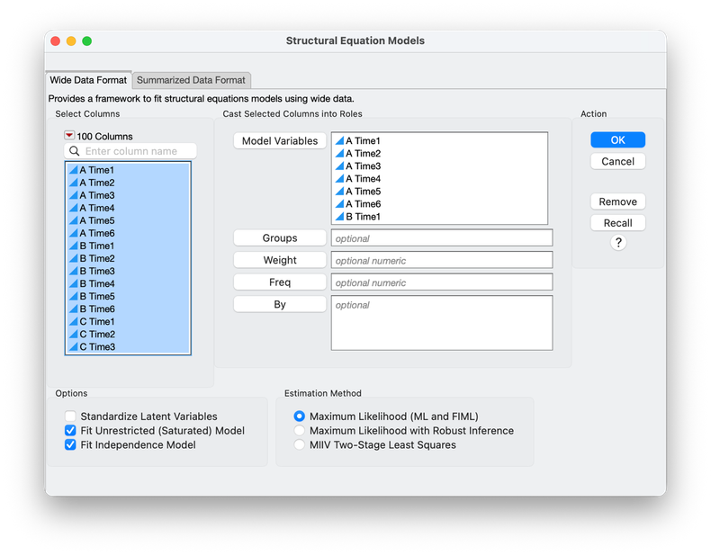

The SEM platform in JMP Pro can be launched by clicking on the Analyze menu, then going to Multivariate Methods > Structural Equation Models. I select all my repeated measures on the launch dialog, click Model Variables, then OK.

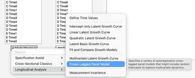

The SEM platform report shows up with a default independence model. Notice the red triangle menu next to the Model Shortcuts button; it’s where the easiest specification of complex models happens.
Upon clicking on that red triangle, we can select Longitudinal Analysis > Cross-Lagged Panel Model.
Note that many types of multivariate autoregressive models can be fit within this option, including those with random intercepts and with latent variables to account for measurement error.

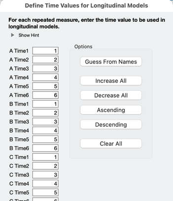

A key piece of information is needed at this point: the SEM platform needs to know what the time order of the measures is. Because we included “TimeT” as part of our variable names, we can click the “Guess From Names” button to get this information in an instant!

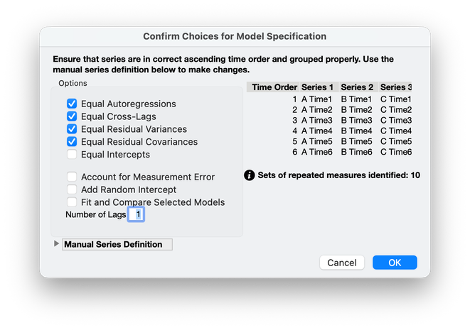

We scroll down to the end, click OK, and all 60 time values are processed. Now the menu with a variety of useful options is available. For the sake of this example, we select a few options that impose equality constraints on 1) autoregressive effects, 2) cross-lagged effects, 3) residual variances, and 4) residual covariances.

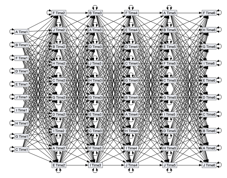

Upon clicking the OK button, a complex SEM is specified. If we hide the equality constraints and covariances from the path diagram (which can be done in the context menu of the diagram), we can see just how elaborate this multivariate system is.
