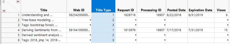

Figure 1: Table of Excel data imported into JMPFigure 1: Table of Excel data imported into JMPSecond, we created a new column called Title Type, with Column Properties Data Type = Numeric and Modeling Type = Nominal. We populated the cells with a repeated sequence of 1,2,3 by typing 1, 2, and 3 in the first three cells in Title Type column, highlighting them, and then selecting FILL>REPEAT SEQUENCE TO END OF TABLE. This gave us an ID column to use to identify the Title field pattern.

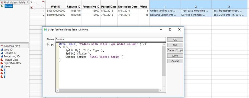

Figure 2: Add Title Type to identify the pattern 1-3 for the three Title TypesFigure 2: Add Title Type to identify the pattern 1-3 for the three Title TypesThird, we split the table (TABLE>SPLIT) to break Title Type 2 and Title Type 3 into two different columns. I saved the script to the data table, too, for reference.
Figure 3: Splitting Title Column into 3 columns by Title TypeFigure 3: Splitting Title Column into 3 columns by Title TypeFigure 4: JSL script to split Title Column into 3 columns by Title TypeFigure 4: JSL script to split Title Column into 3 columns by Title Type

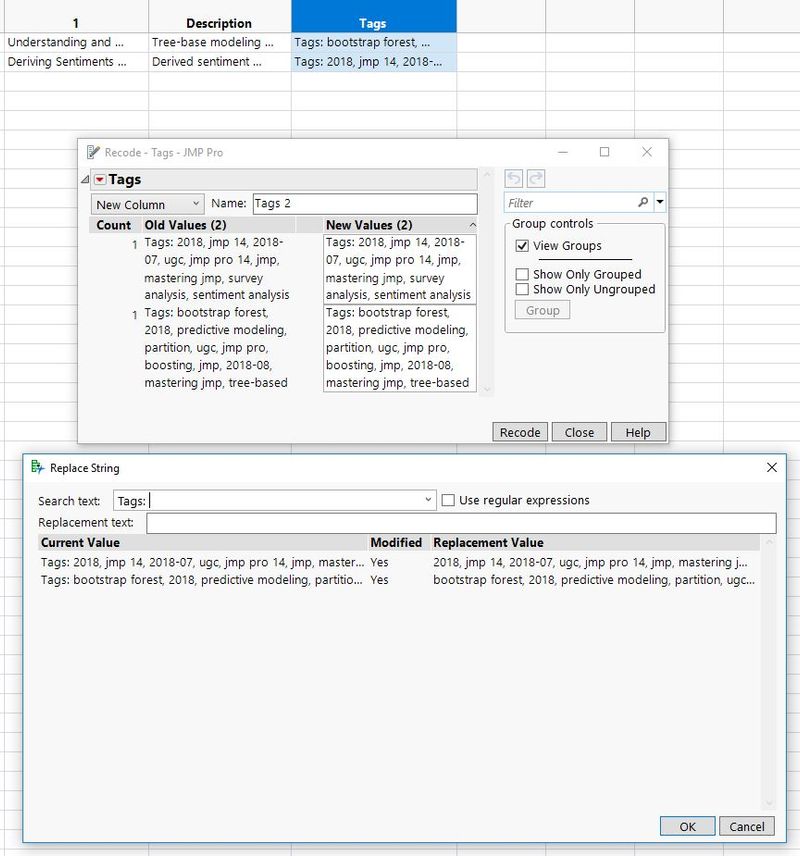

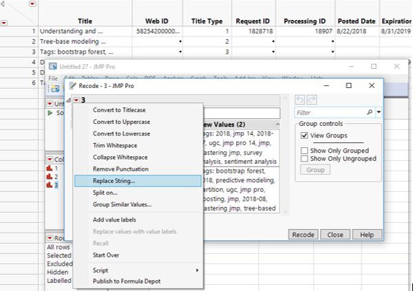

Fourth, we moved some of the columns around, renamed title Title Type 2 to Description and Title Type 3 to Tags. Finally, we got rid of the leading Tags: text on the Tags column by recoding Tags: to a blank space using the Replace String option under the Recode red triangle.Figure 5: Accessing Column Recode using Replace StringFigure 5: Accessing Column Recode using Replace String
Figure 6: Using Recode to replace consistent Tags:  text found in each cell in a columnFigure 6: Using Recode to replace consistent Tags: text found in each cell in a column
