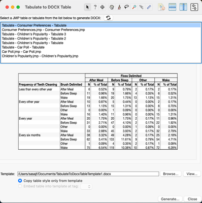

Installing the add-in to your JMP session will install the python-docx package into your JMP Python environment and create a menu item in the Add-Ins menu:drewfoglia_6-1758310583939.png Clicking that menu item will launch the UI and gather a list of all of the tables and tabulates in your JMP session.

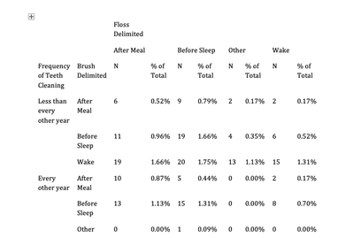

If you subsequently open any new tables or create new tabulates after launching the UI, you can click the refresh button to update the list. Selecting one of the tables/tabulates in the list will give a thumbnail image of the selection. If no template DOCX file is selected, the DOCX table will get generated without any styling applied:

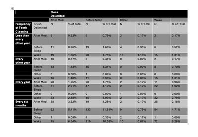

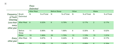

The Browse button will let you select a DOCX to use as a template. The add-in delivers 4 sample template DOCX files and copies them into your DOCUMENTS folder. The View button will open the selected template DOCX in whatever application is your default for viewing/editing DOCX files. The TabulateToDocxTableTemplate1.docx file contains the following stylized table:
Using that template, the generated output now looks like:

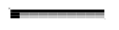

TabulateToDocxTableTemplate2 and 3 are simply different table stylings.
The fourth template demonstrates the tagging capability. When that template is selected, a new option is enabled in the UI letting you select which tag to insert the table into.
