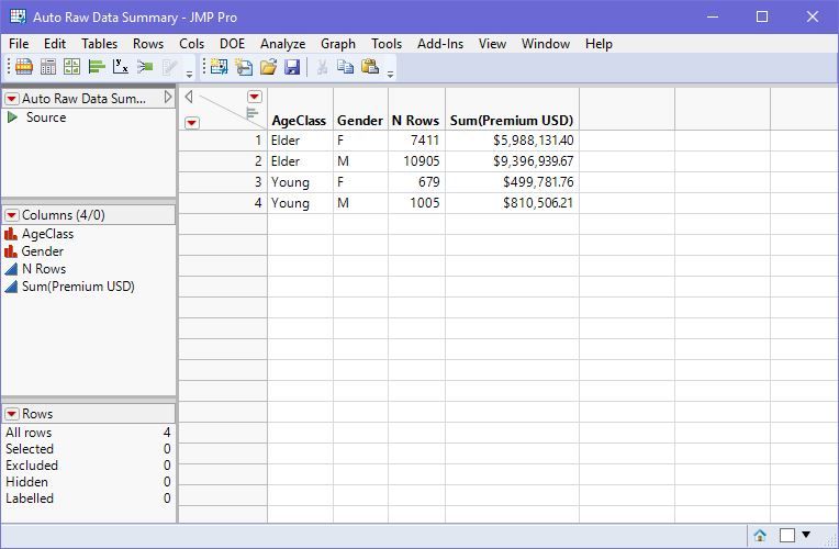

To tackle this issue, it is important to understand how a good data visual is made. Often, a good data visual involves aggregating data into different groups (for example, the different bars on a bar graph). The Tables Summary function in JMP is the perfect tool for performing this task, since it easily aggregates the data in the exact format you need. The result? The significantly decreased number of rows in the data table allows you to create the same exact data visual but with much better loading times in JMP Live!
A great example can be found in the "Auto Raw Data.jmp" file found in the Sample Data library. This data table has 20,000 rows, which would result in a slowdown if a report using this table is published to JMP Live. By using The Tables Summary function in JMP, the data can easily be aggregated to produce a data table with fewer rows. In this example, aggregating the data by AgeClass and Gender produces a table with only four rows, which ensures a much better loading time in JMP Live!
Here's a trick: Use the Tables Summary function to easily aggregate data to produce a data table with a lot fewer rows.Here's a trick: Use the Tables Summary function to easily aggregate data to produce a data table with a lot fewer rows.
