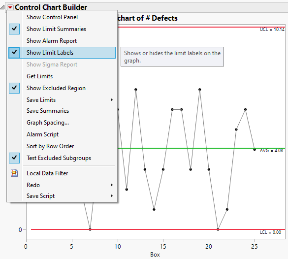

Control Limits Labeled in the Graph
We had requests from users for the ability to label the control limits in the graph. This can be useful when the Limits Summary table is not displayed. “Show Limit Labels” has been added to JMP 16. To see an example of this, run the following JSL:
dt=Open("$SAMPLE_DATA/Quality Control/Shirts.jmp");
obj=dt<<Run Script("Control Chart Builder");
This code opens the Shirts sample data table and creates a C Chart. From the red triangle menu next to Control Chart Builder, select Show Limit Labels.
The control limits are now labeled on the right side of the graph.

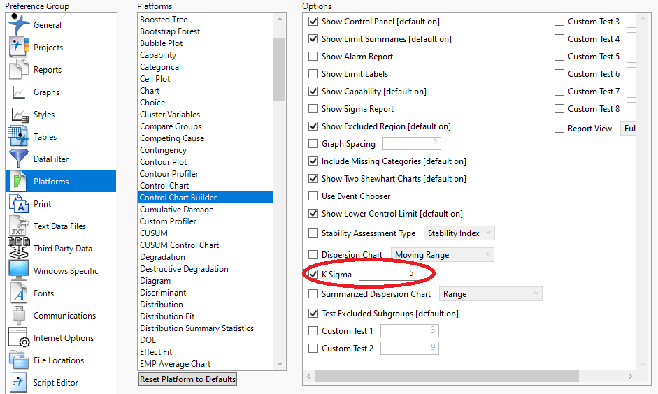

K Sigma option
Process monitoring is often plagued by too many false alarms. This can lead to the alarms being ignored. The K Sigma option, introduced in JMP 16, gives users the ability to specify K. You can find this option in preferences. Choose File->Preferences.  From Preference Group, select Platforms.  From Platforms, select Control Chart Builder.  In the Options section, near the bottom on the left side you will find K Sigma. Check the box and change 3 to 5.
As an example, run the following JSL:
dt=Open("$SAMPLE_DATA/Quality Control/Diameter.jmp");
This script opens the Diameter sample data table and creates an XBar and R chart.
The control limits have been calculated using +/- 5*sigma rather than +/- 3*sigma. This makes the control limits wider and can reduce the number of false alarms.

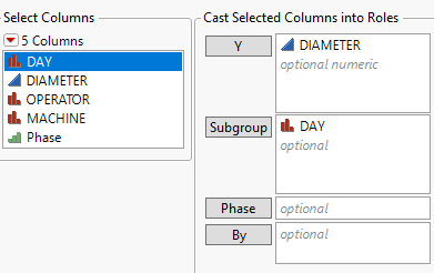

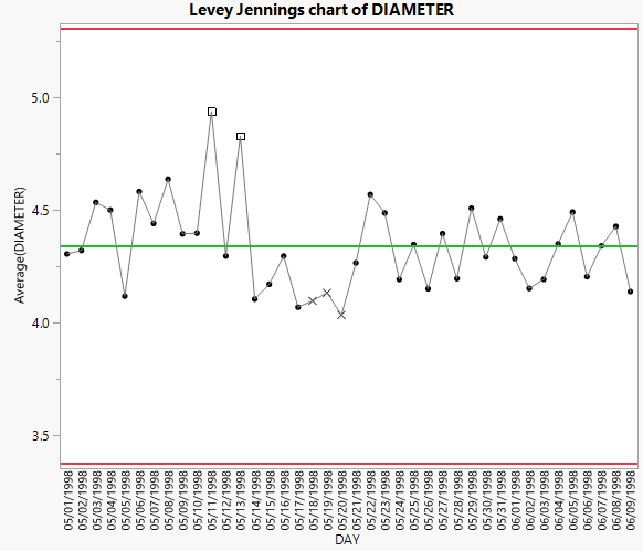

Ability to create a Levey Jennings chart with more than 1 observation per subgroup
Previous versions of JMP did not allow a Levey Jennings chart if there was more than one observation per subgroup in Control Chart Builder. This functionality has been added in JMP 16.
As an example, run the following JSL to open the Diameter sample data table.
Select Analyze->Quality and Process->Control Chart->Levey Jennings Control Chart. Notice that a subgroup role has been added to this dialog.  Specify DIAMETER as Y. Specify DAY as Subgroup.
Click OK. A Levey Jennings Chart is created.
