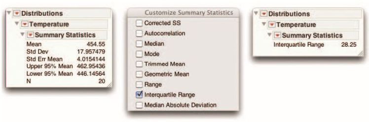

Begin by using the Distribution platform in JMP to generate a table of summary statistics for the original sample. The interquartile range does not show by default in the Summary Statistics table, so use the red triangle menu to request it, as shown in Figure 1. Also, because the bootstrap process operates on all statistics showing in the table to which it refers, uncheck all the default summary statistics that are not of interest in this example. The Distribution Summary table then displays only the interquartile range, as shown in Figure 1.
Figure 1 Tailor Summary Statistics table to show only Interquartile RangeFigure 1 Tailor Summary Statistics table to show only Interquartile Range

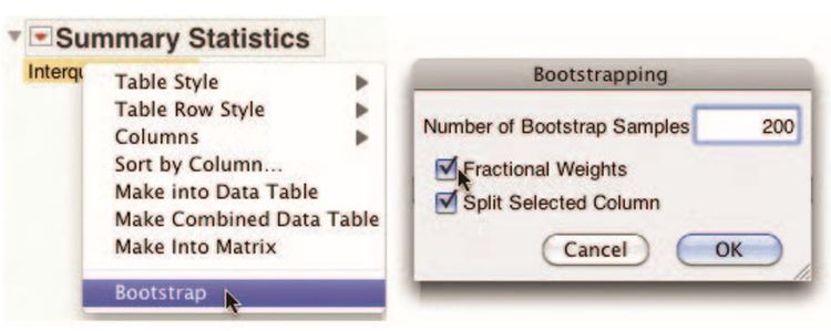

Next, place the cursor in the body of the report, right-click and select Bootstrap from the menu that appears (Figure 2). In the Bootstrap dialog, select the Fractional Weights option – this option provides smoother bootstrap samples Rubin (1981).
Figure 2 Choose the Bootstrap with sample size 200Figure 2 Choose the Bootstrap with sample size 200
This example generates 200 samples. You can enter any number of samples you want, but keep in mind that each sample reruns the Distribution platform and computes the interquartile range for that sample. So, the number of samples you choose depends on the computational resources you have. A large bootstrap request can be both resource and time intensive.

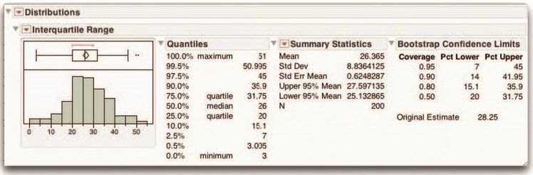

When the bootstrap process is complete, you see a JMP table with the sampling results. These are columns called BootID and Interquartile Range for the Temperature variable. The number of rows is the number of samples you requested plus one for the original sample computation. Now use the Distribution platform to look at summary statistics for the bootstrapped Interquartile Range.
JMP platforms that have the bootstrap option recognize the BootID variable and display the Bootstrap Confidence Limits table, as shown in Figure 3.
Figure 3 Distribution of bootstrapped Interquartile RangeFigure 3 Distribution of bootstrapped Interquartile RangeThe interquartile range computed in the original sample is 28.25 (Figure 1). Note that the interquartile range computed for the bootstrap sample of 200 is 25.4 and that the 95 percent bootstrap confidence limits, taken from the quantiles for the sample, are 7 and 45, which include the original estimate.
