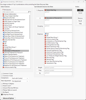

The dialog in Figure 1 enables us to perform the analysis.
Figure 1. Response Screening analysis with Subgroup roleFigure 1. Response Screening analysis with Subgroup role
Note the presence of the continuous variable age in the Subgroup role. While it is always possible to create our own categories of continuous variables, Response Screening does this automatically using tertiles. Finally, to get pairwise combinations of the levels of each factor (e.g., males with blood transfusions), select the Subgroup Twoway option.

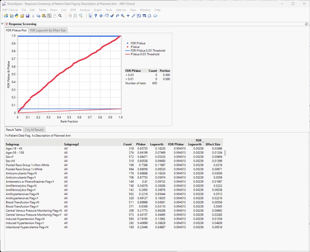

The output is presented in Figure 2.
Figure 2. Response Screening of death within subgroupsFigure 2. Response Screening of death within subgroups
With Subgroup Twoway selected, these 17 factors produce 612 different subgroups (easily visible from the Pvalues data table as there are 612 rows, Save Tables > Save PValues). Of these, 605 subgroups produce p-values (Figure 2). All potential subgroups based on individual and pairwise combinations of factor levels are observed. “Empty” subgroups would be presented in data tables with Count equal to 0 (which is best for transparency and completeness of the subgroup analysis). Subgroups range in size from one patient up to 852 patients.
When a single factor is used to produce a subgroup, as in the first row of the table of Figure 2, Subgroup2 = All. When two factors are used, both Subgroup and Subgroup2 have non-All values listed. The analysis result in the entire population of patients (here, 882) has Subgroup and Subgroup2 both equal to All. Accounting for all of the multiple tests performed with FDR adjustment, there are no differences observed in the rates of death between the treatment arms.

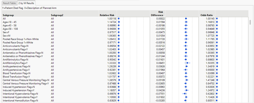

Forest plots of naïve 95% confidence intervals for the relative risk, risk difference, and odds ratio of death are presented on the 2 by M Results tab. These plots confirm few notable differences between treatments, though these analyses are unadjusted for the number of tests performed.
