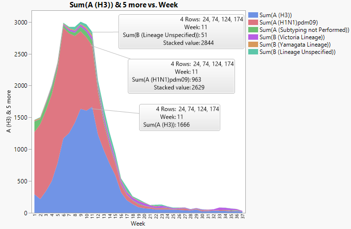

Hover tips
Hover tips are now available on the Area element when over any data point. The tip shows the value for the series as well as the overall stacked value at that data point.
Area Hover TipsArea Hover Tips

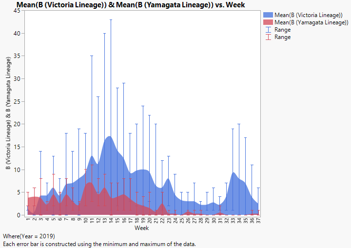

Error bars
When the Area is using the Overlaid or Range area styles, error bars can be displayed just as they would on a Line element.
Error BarsError Bars

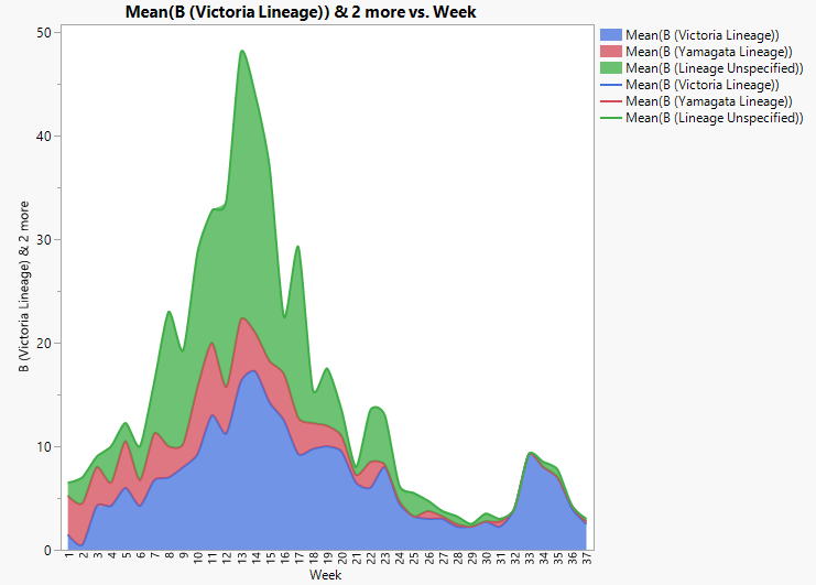

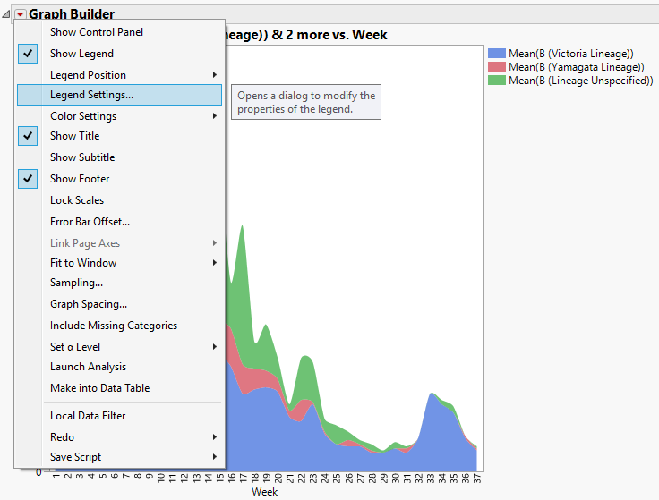

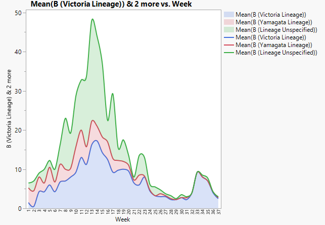

In JMP 15, the fills and lines are separated and controlled through individual legends. By default, the line legends are not shown since the line width is 0. To display the lines and the line legends, the line legends must first be enabled in the Legend Settings dialog.
JMP 15 Legend SettingsJMP 15 Legend Settings
In the Legend Settings dialog, enable the legends for the lines. These are the unselected legends below the fill legends. The preview does not display the lines because the line width is still set to 0. We adjust the line width once the legend is visible.
In this screenshot, the line legends are shown enabled and highlighted in blue:
Turning on Line LegendsTurning on Line Legends
Now that the legends are shown, use the right-click context menu on each legend to set a line width. The line is initially not visible because the line width is zero. Setting a non-zero width makes the line visible in the legend and on the Area element.
Setting Line WidthSetting Line Width
Now the outline of the fill area can be seen and is independent from the properties of the fill.
JMP 15 Lines and FillsJMP 15 Lines and Fills
To make the lines more prominent and the fills more subtle, we can adjust the fill transparency (or color) without affecting the line. In this case below, the fill transparency has been reduced from 0.75 to 0.2 as was done previously with the JMP 14 example.
The difference from JMP 14 is very apparent, as the lines are fully saturated while the fills are highly transparent.
Lines with Transparent FillsLines with Transparent Fills

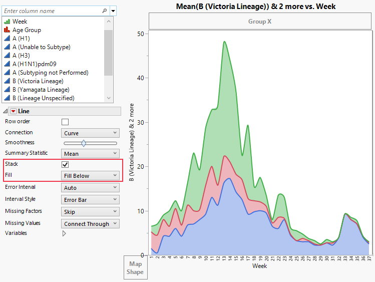

The Area element isn’t the only one that got new features in JMP 15. The Line element also picked up features from the Area element. The Line now has an option for stacking the values.
In the example below, the Stack option is enabled on the Line element. The hover tip includes the stacked value as well as the value for the series.
Stacked LinesStacked Lines
By specifying a fill on the Line element, we can recreate what we had with the Area element.
Area using the Line ElementArea using the Line Element

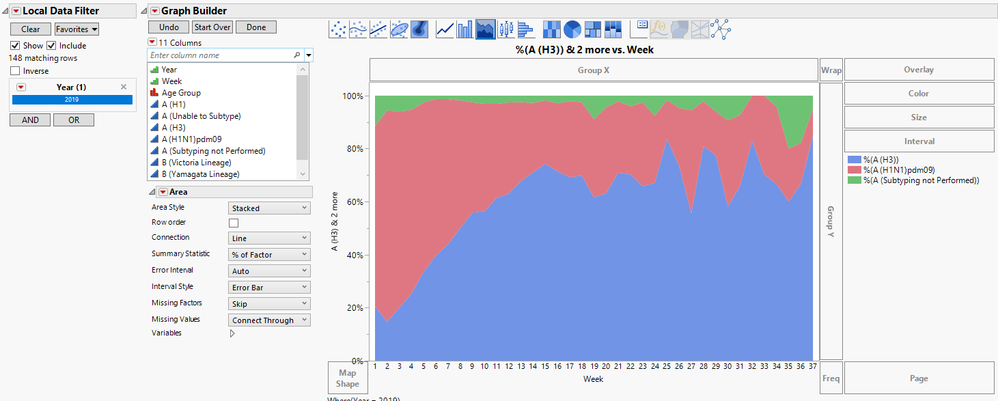

Can it also do 100% stacked area chart? as in the whole graph just adds to 100%
VeryData
Level II
Would I get that by changing summary statistic? To % by factor or something?
paul_vezzetti
Staff
Yes. If you use a summary statistic of "% of factor", I think you will get what you are looking for.
