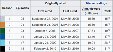

image.pngFor a summer project at JMP, I was tasked with compiling data from the internet. One way I could have done this was to manually search for every single little piece of data I needed across multiple websites; however, that would have taken way too long and was definitely inefficient. Instead, I simply used the Internet Open tool and downloaded all of the data automatically! This allowed for more effective and more accurate data compilation. From there, I was able to filter and sift through the data using the many tools JMP has to offer. To give an example, let’s say that you were interested in the TV show "Lost" and wanted to analyze the length of the seasons.

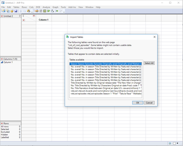

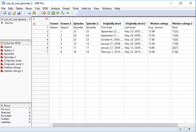

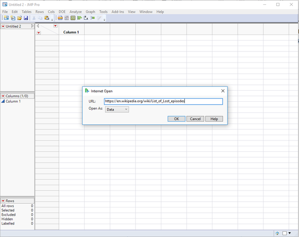

Using Internet Open, you would copy the Wikipedia link (https://en.wikipedia.org/wiki/List_of_Lost_episodes) into the URL spot. Since the data table is already formatted within the website, you can use the “Open as Data” filter. Once you select OK, another window will pop up with the list of data tables JMP found in the website. I want the first data table only, so I select the first line and click OK. Your table should pop up! It’s as easy as that!
