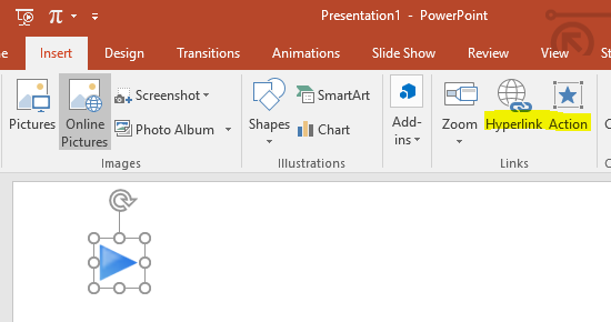

Here's how I did it. There are several simple things to learn. First, you need to insert an icon into the slides. There are several ways of doing this. For example, copy an image from a web page and then paste it into the slides; directly drag an image file and drop into the slides; or follow the guide by clicking PowerPoint menu, starting from the “Insert” tab.

First, make sure an icon is inserted and selected, and the tab “Insert” is selected as well. The “Hyperlink” and “Action” shortcut buttons are highlighted above. Clicking on “Hyperlink” opens a file selection dialog. Choose the desired file and confirm.

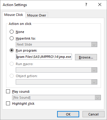

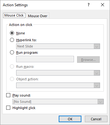

On the other hand, clicking on “Action” opens an “Action Settings” dialog, which you can see below:
Here, select “Run program” and enter the JMP executable location. On my machine, the configured dialog looks like this, below. (Oops, now you see where the next JMP release is!)
