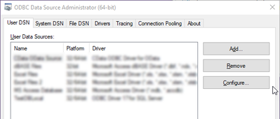

  4. To configure the driver, navigate to Start\Control Panel\All Control Panel Items\Administrative Tools\ and double-click Data Sources ODBC.
  5. Select User DSN or System DSN and click Add.
    • Note System DSN tab configures ODBC for all users of the machine. Configuring the driver via the System DSN tab may be restricted based on your internal security policies. In this case, use the User DSN tab to configure the driver for the currently logged-in user.
  6. Select the respective driver and click Finish.
  7. Create a data source name that describes the architecture and driver, e.g., “32bit SQL Server” or “64bit SQL Server.”
    • While the Description is not required, if you are configuring this to connect to a specific database, you may want to note it here.
  8. Continue configuring the driver according to the vendor’s documentation. Not all database vendors require the same parameters to configure their drivers successfully. Please refer to the driver vendor’s documentation or obtain the assistance of your IT Administrator.
  9. Click Okay again. The source name will appear under User DSN or System DSN, e.g., “32bit SQL Server” or “64bit SQL Server.”
