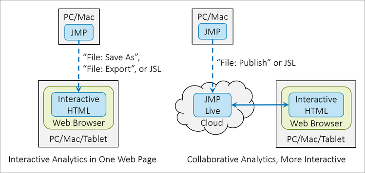

By choosing "File: Save As" or "File: Export", you can export any JMP report to Interactive HTML. This creates a self-contained web application: a single file with extension ".htm" or ".html".
This file can be loaded into any modern web browser, to view the analytics and explore the data. The file can be emailed or stored on a shared drive or website to share with others. As shown in Figure 1, the connection is one way: JMP creates the file, but the file can't communicate with JMP.  With JMP Live, the connection is bidirectional, which enables more interactivity.
Figure 1. JMP Interactive HTML and JMP LiveFigure 1. JMP Interactive HTML and JMP Live
Modern web browsers are fast, so we only use the two-way connection when needed. Otherwise, our software runs solely in the web browser. This architecture maximizes speed and minimizes network transfer costs for our customers, so we plan to maintain and improve it in future releases.

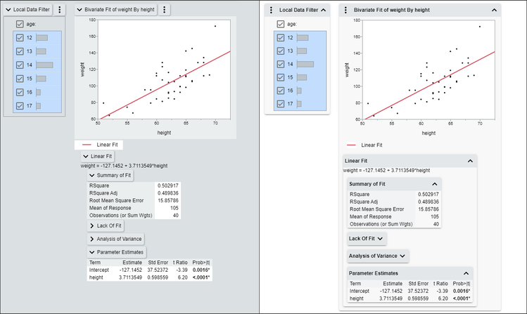

We've also begun to support two color themes: gray and light.
Figure 2. Gray and Light ThemesFigure 2. Gray and Light ThemesFinally, we found a reliable algorithm for touchscreen detection. This enables us to deliver two user interfaces, tailored to desktops or tablets. Buttons and other controls can be sized correctly for the device. On the desktop, switching modes is no longer necessary to brush data or select multiple objects, which saves time for the user.

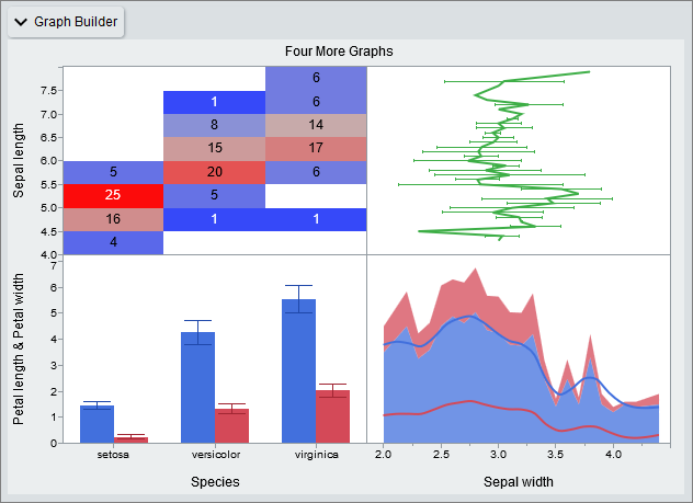

Figure 3. Custom Graphics Script in Discriminant PlatformFigure 3. Custom Graphics Script in Discriminant PlatformAlso, more interactive features are supported in reports from Graph Builder. The following are examples:
  • Bar Charts (Side-by-Side Interval Bars)
  • Line Plots (Horizontal Response, Stacked Lines)
  • Area Plots (Horizontal Response, Stacked Areas)
  • Heat Maps (Label by value, categorical color roles, log scale, more statistics)
Figure 4. More Interactive Graphs from Graph BuilderFigure 4. More Interactive Graphs from Graph BuilderWe also added support for conditional data filters, in which the values of one filter are determined by another.

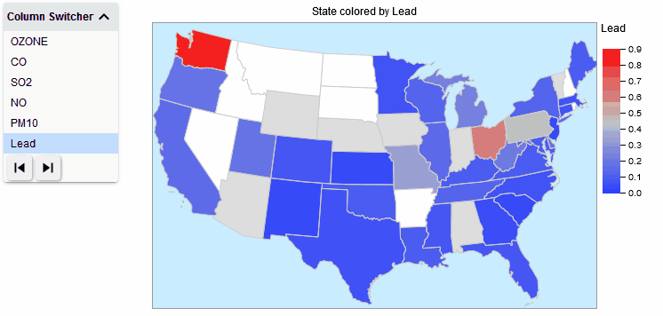

JMP Interactive HTML can do many things, but as a standalone Web application, its interactivity is limited. JMP Live can rerun the analysis. Two ways to rerun an analysis are to switch columns, and to exclude rows.
JMP Live supports the Column Switcher. You can switch columns to rerun an analysis, just as in JMP.

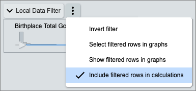

Figure 5. Column Switcher in JMP Live, Exploring Air Quality DataFigure 5. Column Switcher in JMP Live, Exploring Air Quality DataAlso, in JMP LIve, data filters support the Exclude row state, in addition to Select and Hide states. Exclude or include rows with a data filter, and again the analysis is recalculated.
Figure 6. Data Filter Include/Exclude MenuFigure 6. Data Filter Include/Exclude Menu
Finally, you can also exclude rows without a data filter. For example, to exclude an outlier, select it, then choose the "Exclude and Hide Selected Rows" menu. Again, this regenerates the entire analysis.
Figure 7. "Hamburger" Include/Exclude MenuFigure 7. "Hamburger" Include/Exclude Menu
