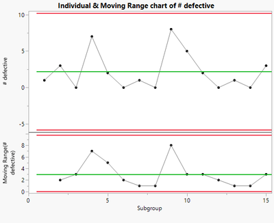

We know our goal is to create an NP control chart of # defective. To do this using the drag-and-drop interface of Control Chart Builder, select Analyze->Quality and Process->Control Chart Builder. Drag # defective to Y. You get an IMR chart.

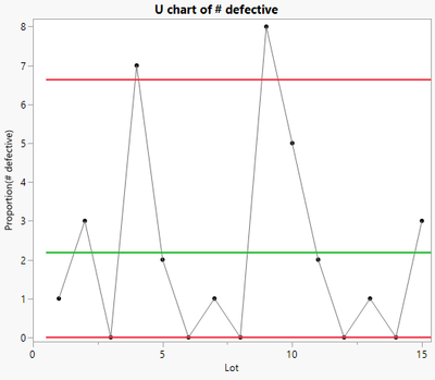

Drag lot to Subgroup. Since the response is the number defective, change the chart type from Shewhart Variables to Shewhart Attribute. Now you get a U chart.

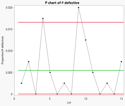

Since we are dealing with events that have two outcomes – defective or not defective – and the number of trials is is fixed, we should be using the binomial distribution. Change the Sigma to Binomial. Now you get a P chart.

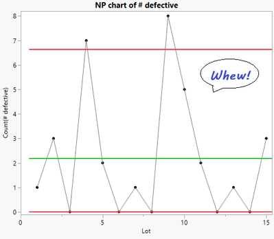

To plot counts rather than proportions (NP Chart), change the point statistic from Proportion to Count.
You finally get the NP chart you knew you wanted in the beginning. Whew! That was a lot of clicking and a lot of different chart types that were generated during this process.

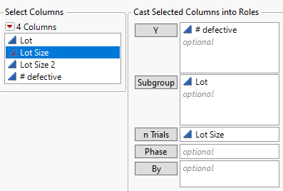

If you know what chart type you wish to create ahead of time, it is often easier and quicker to use a dialog entry into Control Chart Builder. For this example, select Analyze->Quality and Process->Control Chart->NP Control Chart. Specify # defective as Y. Specify Lot as Subgroup. Specify Lot Size as n Trials.
Click OK. You get the same NP chart as above with many fewer mouse clicks!

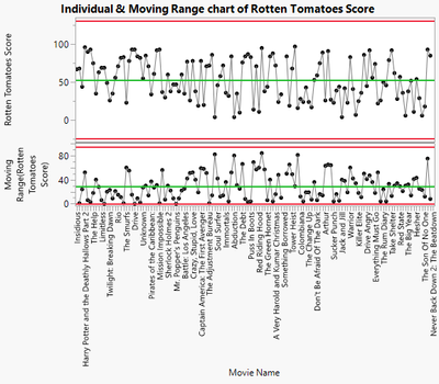

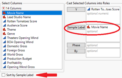

Select Analyze->Quality and Process->Control Chart->IMR Control Chart. New for JMP 16.1 is the Sample Label role and the Sort by Sample Label checkbox. Specify Rotten Tomatoes Score as Y and Movie Name as Sample Label. By default, the Sort by Sample Label checkbox is checked.  Uncheck this box. This means that the subgroup role will be sorted in data table row order rather than alphabetical order.
Click OK.
You get an IMR chart using Movie Name as the sample label. The subgroup role is using data table row order rather than alphabetical order for Movie Name.

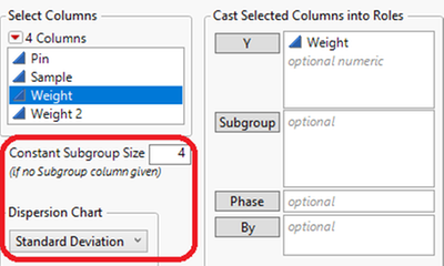

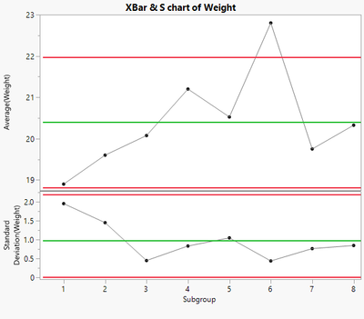

Go to Analyze->Quality and Process->Control Chart->XBar Control Chart.  New in Version 16.1 is the Constant Subgroup Size field that appears in the lower left and the Dispersion Chart drop down that also appears in the bottom left of the dialog.  Specify Weight for Y.  This data table contains a subgroup column: Sample.  Each level of Sample has 4 observations.  Some data tables do not contain a subgroup column.  If this data table did not contain the column Sample, we could get the same analysis by specifying 4 for Constant Subgroup Size (rather than Sample as Subgroup).  Let’s do that here.  Specify 4 for Constant Subgroup Size.  Change the chart type from Range to Standard Deviation.
Click OK.
You get an XBar and S chart with a subgroup sample size of 4.
