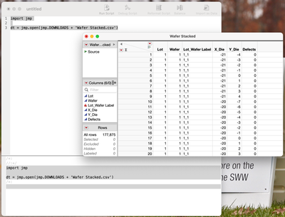

Paul_Nelson
Staff
The JMP Open, whether it is Open() in JSL or jmp.open( ) when given a CSV file will open it as a data table.  The import jmp package capabilities give the ability to read, modify and create columns from the script.
import jmp
# just like you would do in JSL.
dt = jmp.open('Wafer Stacked.csv')
