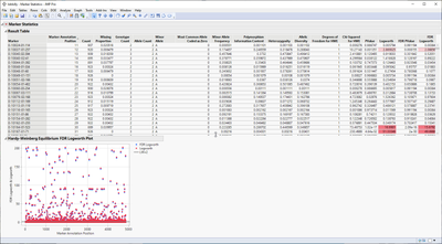

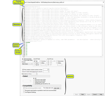

The typical starting points are File > Open for data in a single file or File > Import Multiple Files for data from several files. Many common formats such as vcf, bed, gff, and IDAT are automatically detected. The import routines typically create a JMP table in “wide” form, with samples as rows and genes as columns, and this wide table is ready to go for use in many JMP Pro platforms, depending upon analysis objectives.

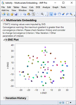

Many of the data table operations and analysis platforms have been optimized for these “wide data” problems, allowing the user to easily apply JMP Pro’s analysis tools with many thousands of variables. The release also features three new platforms that are particularly relevant: Marker Statistics, Marker Simulation and Multivariate Embedding.
