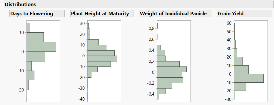

With this data, the idea is to find markers associated with the following traits: days of flowering, plant height at maturity, weight of individual panicle, and grain yield.
Distribution of the four traits

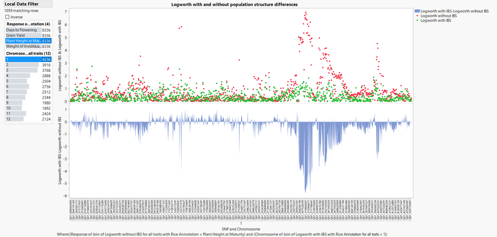

Identifying the true and false signals is simply a matter of subtracting the logworth with population structure minus logworth without population structure. In the graph below, we can see the superimposed logworth with (in green) and without (in red) population structure. The arrows highlight signals in markers that are supposed to be highly associated with a trait (considering no population structure), The bottom of the graph represents the difference between logworth with and logworth without population structure, allowing the true and false positives to be distinguished. It clearly shows a significant difference when comparing the logworth with and without population structure. Look at the number of false positives! (negative difference values).
Graph 6 showing the FDE logworth difference with and without population structure.png
Graph showing the logworth difference with and without population structure
