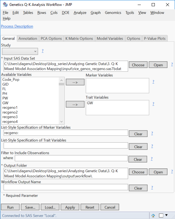

  2. On the General tab, select rice_genos_recgeno.sas7bdat as the Input.1_input_data.png
  3. Select GW as the Trait Variable. The Q-K workflow can handle all of the traits at once; but to perform K Matrix compression, the analysis will need to be done on a trait-by-trait basis.
  4. Enter recgeno: in the box under List-Style Specification of SNP Variables.

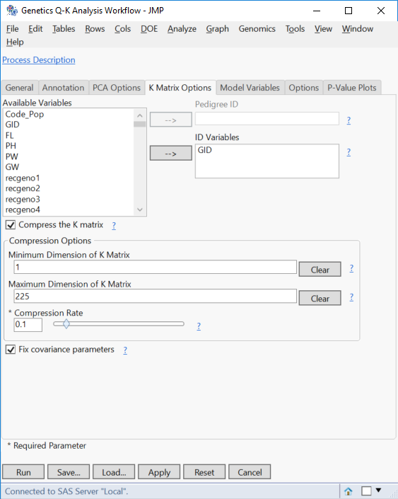

  9. On the K Matrix Options tab, check the box next to Compress K Matrix.
    • This option will only be available if a single Trait Variable is specified on the General tab.
  10. In the Compression Options section, set the Minimum Dimension of K Matrix to 1 and the Maximum Dimension of K Matrix to 225.
    • To let JMP determine the optimal dimensions for the K Matrix, these boxes can be left blank.
  11. Set the Compression Rate to 1.
    • This means the K Matrix will be compressed by 10% at each compression level. Lower numbers for this option will increase the precision of the compression by causing more iterations of compression.5b_KMatrix.png

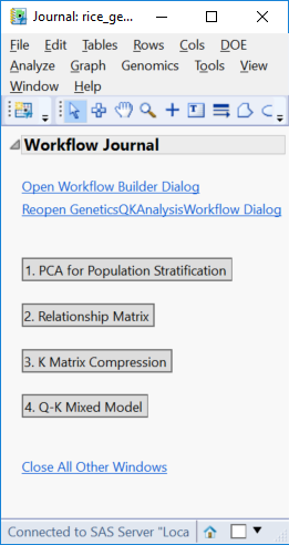

  16. Click Run to launch the analysis. When the workflow analysis is complete, the following JMP Journal will be displayed.7_journal.png
