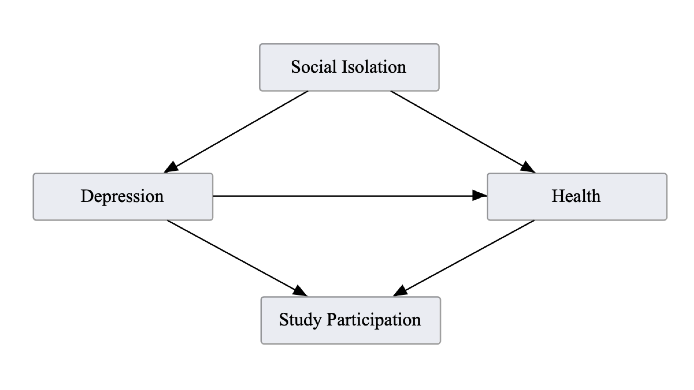

Figure 1. An example DAG from Dong et al. (2025).Figure 1. An example DAG from Dong et al. (2025).
1. Draw a directed acyclic graph (DAG) that represents the data-generating process.
A DAG has directed arrows, showing which variables are causes and which are effects. A DAG is acyclic, meaning that if you follow the arrows directionally down a path, you will never return to the variable at which you started. Drawing a DAG will help you categorize your variables and identify confounders.
