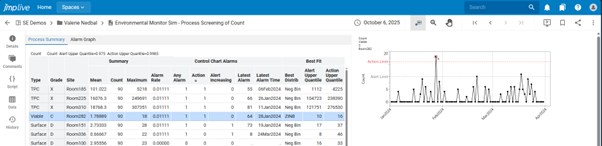

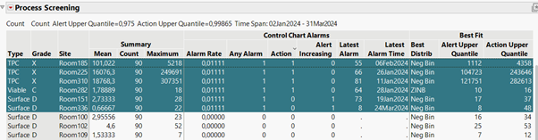

The EM team used Process Screening to evaluate all sampling locations simultaneously across multiple parameters and to rank them by statistical significance. Notably, with the enhancements introduced in JMP 19, Process Screening now supports count‑distributed data and automatically displays alert (2‑sigma) and action (3‑sigma) limit alarms, an especially useful capability for environmental monitoring datasets. In addition, Process Screening automatically fits a number of different distributions and uses the distribution that best fits the data to determine alert and action limits for each process based on the fitted distribution.
The Process Screening results aligned seamlessly with the floorplan heat maps, confirming statistically significant upward trends at six sampling sites. By regrouping the data by sample type, cleanroom grade, and location, the team was able to pinpoint the precise sources contributing to the environmental drift. Notably, two sample types displayed increasing alarm trends, indicating the early stages of a major excursion.

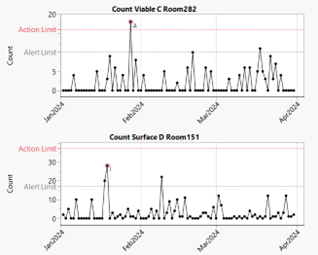

To confirm the emerging trend, the significant sampling locations were selected and further examined using the control charts embedded within Process Screening. By simply highlighting the affected sample types and applying the ‘Chart as Selected’ option, the corresponding control charts were generated instantly. As a result, the team could pinpoint which sample types exhibited out-of-trend behavior and identify the specific days that major deviations occurred.

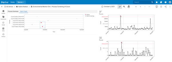

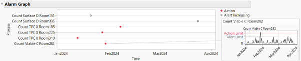

When a large number of control charts need to be reviewed, the Alarm Graph offers a streamlined way to visualize all excursions above the action limit, as well as any upward trends over the selected monitoring period. The team could easily visualize when and where contamination issues occurred.
